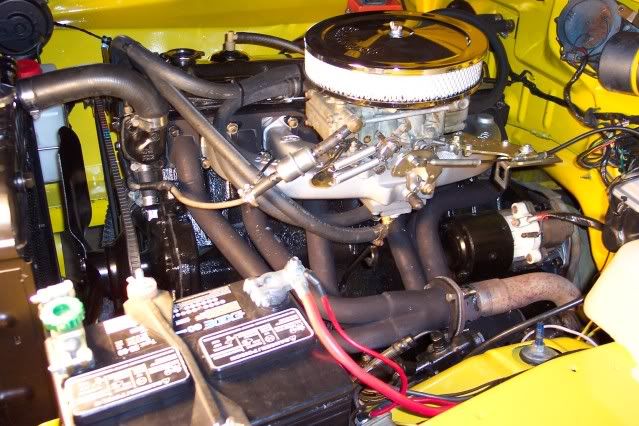

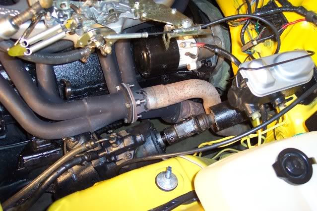

I have Hooker headers on my Swinger and connected to a true dual exhaust to the rear bumper
Do you have any pics of them installed? How do you like them?

I will try and get some pics today, they are a little loud when you get on it but not bad at cruise.Am considering a H pipe.

Do you have a good shot of how low the headers hang down?
