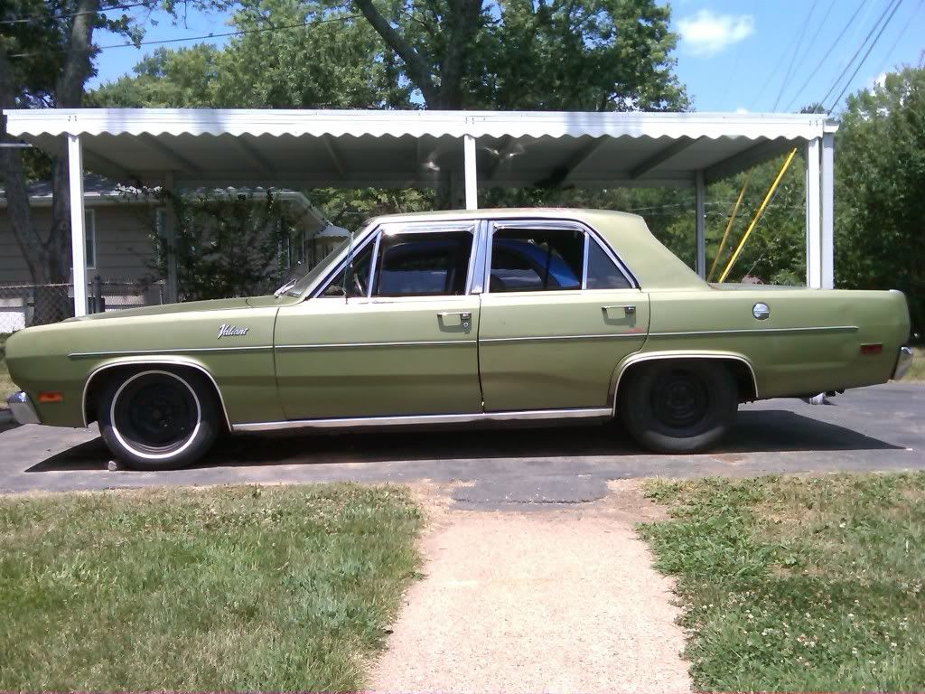

i got it done a while back but haven't had time to post. i love where it sits and the pinion angle seems to be ok too. i didn't flip the shackles from side to side as they are identical. i just used some uni-bits and made the holes a little bigger. it wasn't all that bad and it was free! can't complain there. thanks for all the help everyone.

here's a pic of how it looks now.
http://i228.photobucket.com/albums/ee57 ... 2-1247.jpg

That looks lean and mean, low and not too slow. 8)
