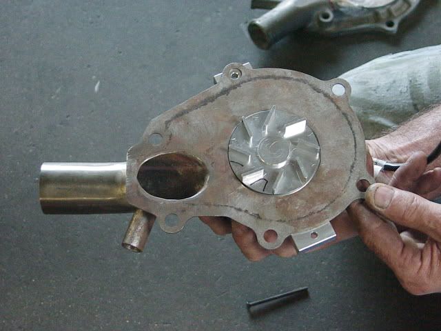

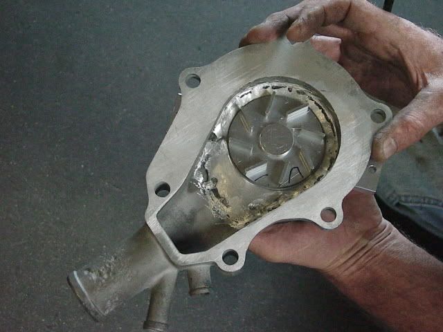

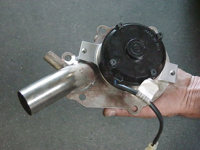

Here are some pics to look at. Description and what I went thru to follow:

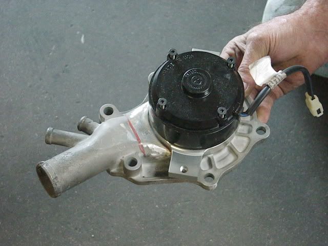

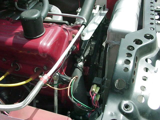

Pics 1 and 2 were my first attempt,didnt like that the impeller wasnt further towards the block,was concerned that the water would just get swirled around and not pushed tru the motor....Attempt # 2,pics 3 and 4 got the impeller into the block,unfortunetly the water spigot I welded on didnt hit the water port in the block.At this point,about 20 hrs in I decided to get a new stock pump,cut the front off and was trying to figure how to mount elec motor to stock impeller,that failed also.Decided to get the Stewart in line pump and cap my butchered stock pump,Stewart was out of stock waiting on parts,Summit was out of stock,Jegs only had a remanufactured one so thats what I got,,,capped my waterpump hole, plumbed pump,tested it and it didnt work,binding impeller,,,,,Will finish story tonight,my finger is sore,Mark
