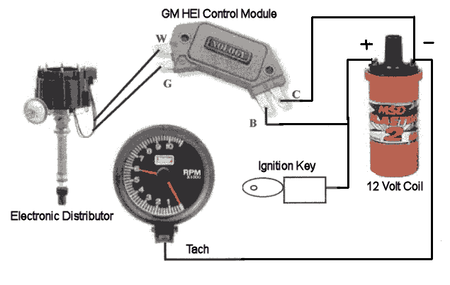

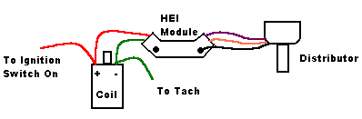

Can the HEI upgrade used on our Slants be used on a 83 ford 302?
If so How? Dizzy and ecu or is there an all in one option?
Been searchin' all AM no luck Thanks
robert
PostPosted: Mon Oct 12, 2009 10:07 am
I can think of no reason why you can't use an HEI module to replace the failure-prone Ford module. The HEI module should work just fine with a Ford electronic distributor and coil.
PostPosted: Mon Oct 12, 2009 10:15 am
Posts: 13431
Yes!
http://www.bronco.com/cms/node/25
I plan to do this to my 84 Ford van eventually.
PostPosted: Mon Oct 12, 2009 2:33 pm
Posts: 9092
I'm pretty sure the HEI setup will work with any 2 wire electronic distributer.
