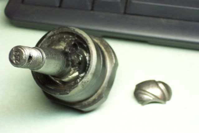

A ripped ball joint rubber, along with a lot of squeaking from the front end prompted this investigation. After removing the ten month old, three thousand mile small ball joint, I discovered that the ball had failed, and was in two pieces. No wonder the car was protesting, and getting a bit sloppy…

I believe it purchased the joint from Napa, costing around 70 bucks. Unfortunately Napa’s little slips sometimes go through the wash in a pocket, or get misplaced during the heat of battle. Filing sales slips is not my strong suit. I never purchase the cheepo line of parts, so it was one of their better units. There are two numbers stamped on the joint: one adjacent to the grease fitting, 7022; and one on the end of the tapered shaft, 253.
As you can see the joint looks to be in new condition except for the big chunk the fell out when I removed it from the UCA, and degreased it.
