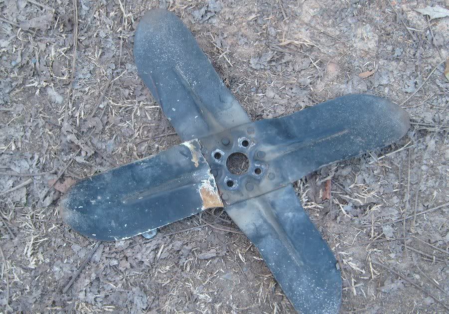

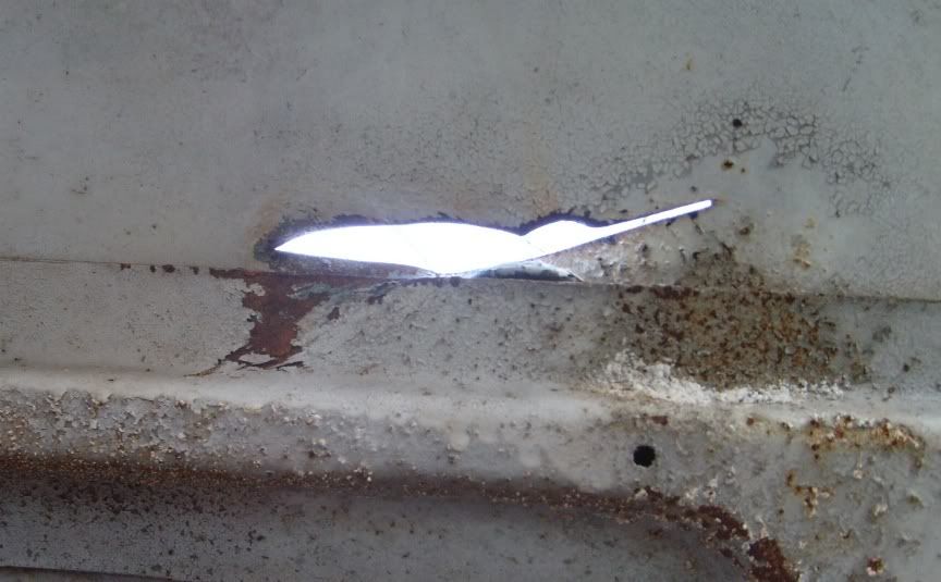

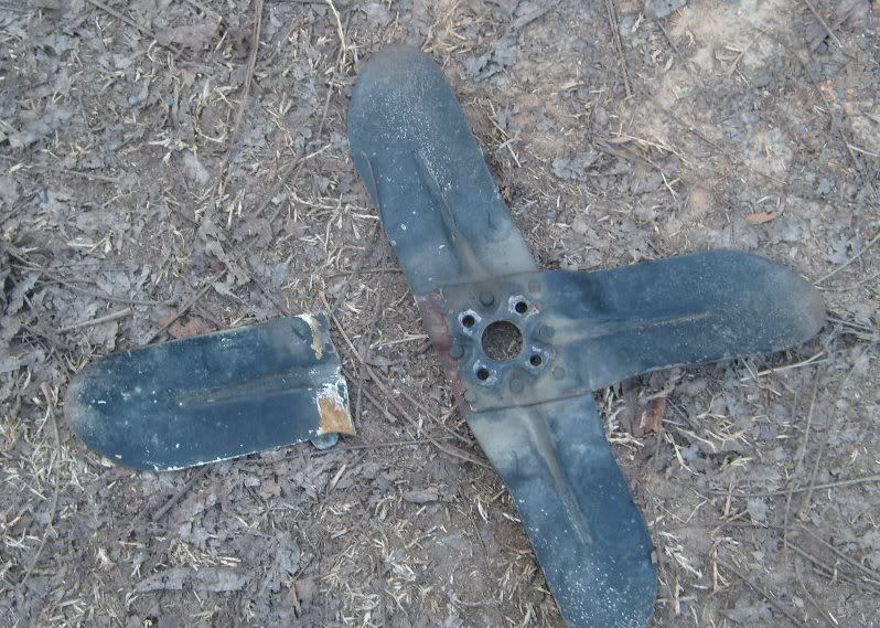

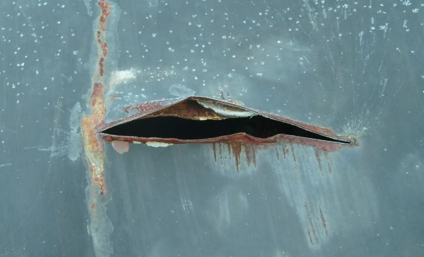

A few months ago I had a stock 4 blade fan explode on me, wiped out the hood and the battery. I was only turning about 3800rpm when it let go. Earlier that morning I had been doing some tuning, and was reving the engine from under the hood, a few more revs and it could have gotten me then.
The hood where it escaped
Inside the hood
The fan
BTW The fan looked ok when installed, and never gave any indication of a problem, well until it came out the hood. No more fixed factory fans for me, it will get an electric fan in the future.
Stay safe around those fixed fans!
