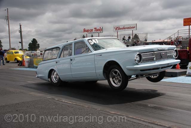

"SIX PACK", 66 Valiant, owned by Barry Harrison, regularly carries the front wheels.

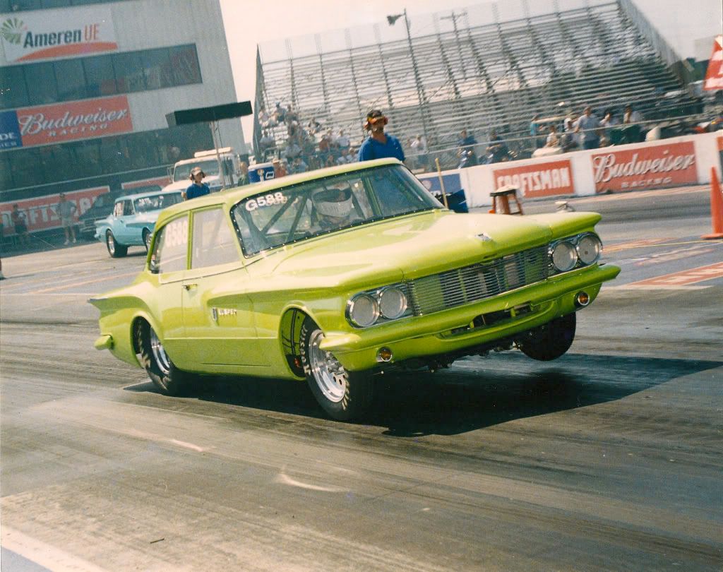

PostPosted: Sat Jul 31, 2010 3:57 pm
6 Pack Dart
Posts: 2281
Location: Eugene, Oregon
This is Dave Mueller's
Richard
Part of Tyrde-Browne Racing

PostPosted: Sun Aug 01, 2010 6:54 am
Joined: Fri Jan 05, 2007 2:57 pm
Posts: 355
Location: Florida
Richard
This one pulls wheelies and is fast :!: Very impressive. Makes me wonder what this car would run with wheelie bars to keep the front end down :shock:

PostPosted: Sun Aug 01, 2010 2:10 pm
Posts: 419
Image[/img]
