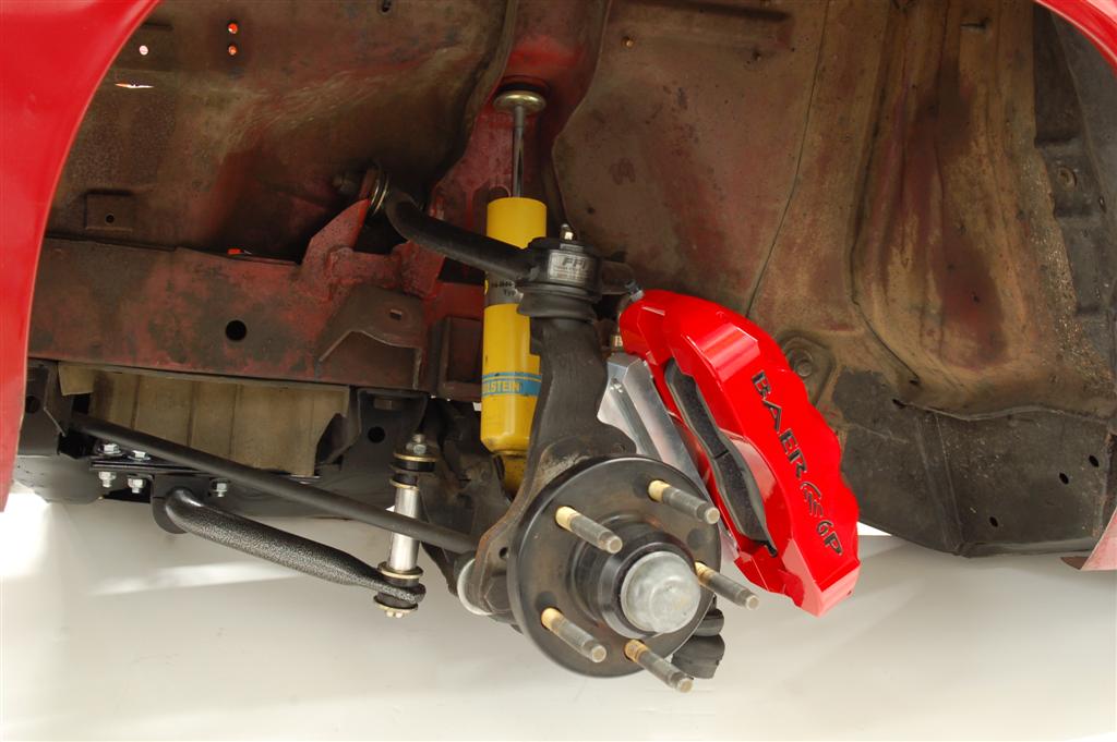

Here is an A body with a Hellwig tubular anti-sway bar. This is a '68 A body with a '73 style K frame. Same basic setup will bolt right on to your '76 A body. They are basically the same under the skin.

I like those shocks, andyf.
PostPosted: Fri Nov 05, 2010 6:46 pm
I have the same dampers and spindles, but different calipers and rotors. Oh, my torsion bars are a little smaller at 1.14" too. :) Please excuse the rust. The car is sitting outside at the moment.

andy, josh- thats not a KH style two-piece rotor / hub assembly, is it? (with fancy caliper brackets, of course )
