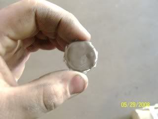

The carb body is drilled and a nipple of some type is pressed or epoxied in place. The area you want access to is behind the PV in the main body. Make sure that area is completely sealed. The PV is modded in the below picture so the spring keeps the PV closed. Once boost rises and builds pressure in the chamber behind the PV it then opens the PV to richen the mixture. There are many different ways of doing this.
The PV channel restrictions need to be enlarged for boos as well. this is discussed in Hangar 18.

The power valve normally works on a pressure differential between the carburetor body side of the valve and the float chamber side of the valve. Vacuum is just lower pressure. Vacuum doesn't pull the valve closed it's the pressure on the float bowl side of the valve which pushes it closed against the spring. If the valve is a 6.5 then there has to be 6.5" Hg more pressure in the float bowl than the manifold to close the valve.
I like the backwards valve that is sealed. Sealing one side of the PV makes it an absolute pressure device rather than a differential pressure one. If you have the back of the power valve (carb body side) connected to the carb hat then it's at the same pressure as the float bowl where is the differential pressure to make the valve open?

Good question. All I know is it works. I can see it on my AFR and the before and after modification brought the part throttle AFR down to 13:1 from 15:1+. Some guys have gone as far as to use an alternative pressure source to open the PV. There are lots of exaples on turbomustangs.com
