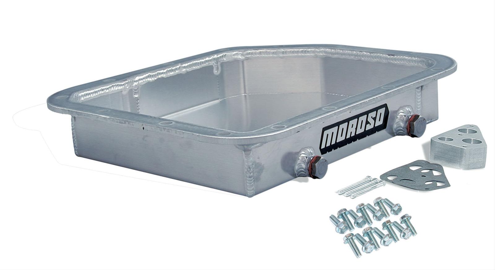

If I can get away with drilling an additional hole in the existing extension, I'll do it. Fabricating a new one is beyond my capabilities.
The only multi-hole filter extension I've found so far is the one included in this Moroso aluminum pan. It actually has 3 holes, but it looks like 2 of them match up with the ports in the early filter. Not sure what the 3rd hole is for. Regardless, I don't want to drop $200 on this. The whole reason I bought the Mopar pan was the $60 price tag. I don't necessarily need a deep pan.
I'll update this thread again when I finally get around to disassembling and inspecting. For now I'm just waiting, and thinking too much.
