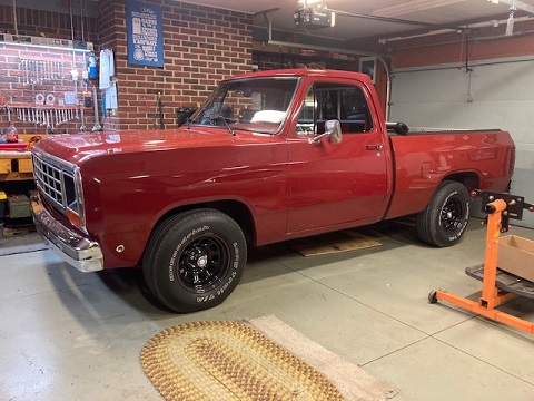

The winter of 2020 is upon us folks that reside in IN. With that, the 83 D150 is now quietly parked in the garage, and will be for the next five months.
The 83 D150 has accumulated a little over 40,000 miles since its major re new. It has been reliable and efficient and useful, but over time there are wear and tear items that accumulate that need attention. I put together a list of 16 items that I will address over the next month or so. Garage Times are Good Times.

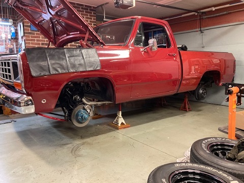

Got to check off a couple of items on the list. Front wheel bearings serviced, new front brake pads and rear shoes checked.
Also had the tires/ wheels re balanced
The front brake pads certainly still had life in them, but it was one of those deals, since I was in that far, go ahead and do it all.
The front and rear axels on this slant powered D150 are the heavier duty option. For the front axel on an '83 D150 there is a 3300 axel and a 3600 axel.
This truck takes the 3600 axel wheel seals and has the 11.75 disks to go with it. The rear axle has 11 inch drum brakes.
