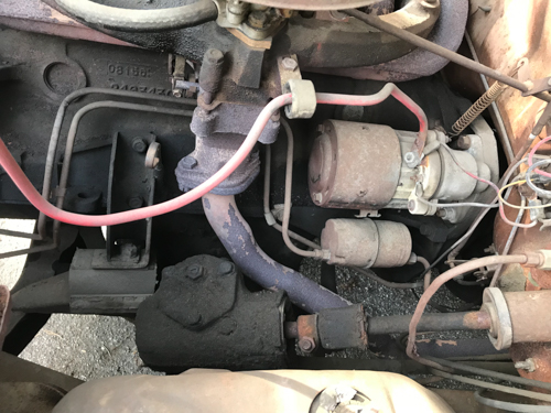

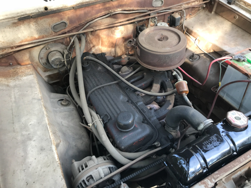

My little girl just bought her first car 64 Valiant . we need help in rebuilding and redoing the engine, switching to dual master, adding disc brakes if needed. we also need upholstery , looking to maintain the original look as much as makes sense from the point of safety. my number is 310 748 1110 joe , im in the los angeles / la crescenta area.

If the engine is in decent shape, you might want to simply do a heavy tune up and a couple of upgrades and run it. Rebuilding an engine can introduce new problems. My first thoughts on tuning and upgrading the engine: adjust valve lash, install electronic ignition of some kind, adjust timing and carburetor.
Disc brakes and good wheels and tires are excellent upgrades for safety and handling.
