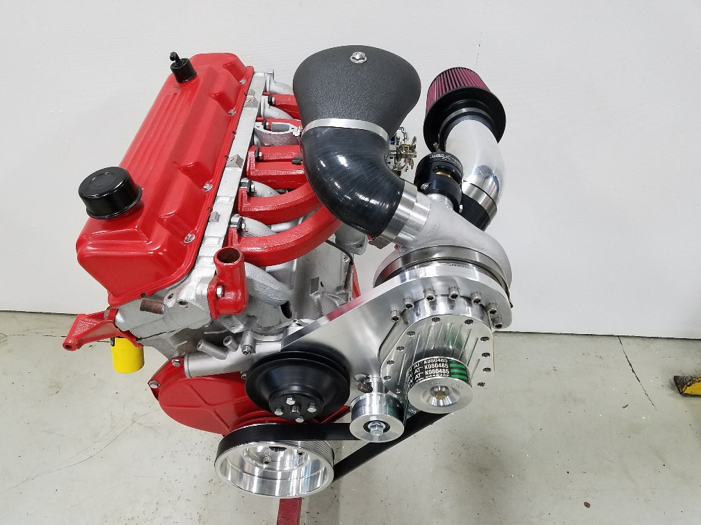

We have a nice and simple package for the slants. Dr. Dodge is doing a book on setting one up for boost with our setup. Should be out soon.
Torqstorm
