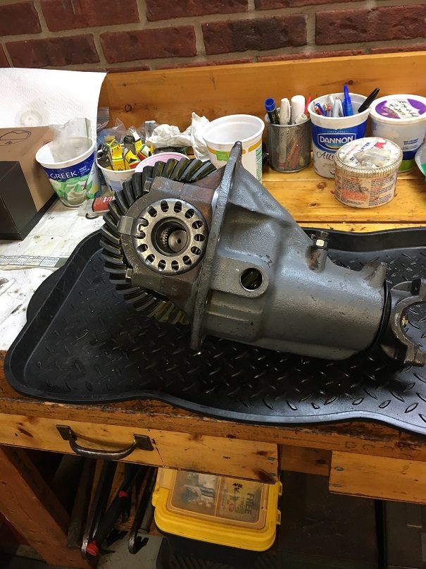

ran in to a few EMI / RF issues affecting the MegaSquirt ECU that is controlling fuel and ignition. The good news is, that is resolved, so back on getting the 68 Barracuda prepped.
On my list of items to resolve was a 'whirring' noise from the differential during deceleration. I have an 8.75 / 742 cone sure grip with 3.55 gears installed. Originally the car had an 7.25 rear end, I had picked up the 8.75 as a complete package, was told it was from a '69 Dart, that rotted away parked in a field in Norther MI. I went through the 742, changed out all the bearings, seals, disassembled the sure grip, the cones had not bottomed out, but I had them trimmed .010 to account for use, re used the original 3.55 ring and pinion. Put it back together and ran it.
That was about 3 years ago, and maybe 35 runs down a strip. I wanted to take it back down, verify that bearings / races were OK and resolve the deceleration noise.
https://www.youtube.com/watch?v=A1qj6LA39Sc
taking things apart is always fun.
it gets serious when wrenching components together.
PostPosted: Sun Apr 15, 2018 5:27 pm
pulled the ring gear to check pinion bearing loading,
it was turning at 2.5 inch / lbs with the seal installed, that is fine
PostPosted: Sun Apr 15, 2018 5:31 pm
, the existing ring gear bolts /threads looked fine, I cleaned the Loctite off with a wire brush,
re applied blue Loctite to the threads, put a light coat of ARP bolt lube on the under side of the bolt head and re installed
PostPosted: Sun Apr 15, 2018 5:43 pm
the 'chunk' is back together
concerning the whine on deceleration, I also checked ring and pinion backlash prior to dis assembly.
the spec for a new gear set is .006 to .008 backlash,, I found .017 ,,, double the backlash specification,
as the gear set I am using is used, I believe it is the original to the 742 case it certainly did not wear in to cause the excessive backlash, possibly I did not have enough pre load on the carrier bearings and the carrier just shifted a bit, or I just missed the set up during assembly.
To eliminate one root cause, I spent a lot of time making sure the side adjustors moved freely in the housing caps, cleaned up a few thread burrs ,,,The side adjustors run in easier now that they did before.
I was really careful this time, I set the back last at .010, that is on the high side of the tolerance but I believe that is fine with a used gear set.
the plan for tomorrow is to set the center section back into the rear housing, re install the axels / brakes..
