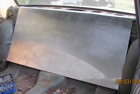

No word on the new trunk floor, but I got the back seat firewall made. It doesn't need to be pretty as it will be covered with carpet.

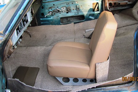

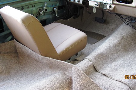

Carpet is going to be a pain. It kind of looks like the driver pad is too far back. If I move the pad close to the area it should be, the edge between the front and rear carpet is under the front seats. Anyway, it will be nice to get the interior at least partly done. One other thing I just noticed. The interior of the car is original 'Fawn' (tanish) color and the outside was originally a sea green. On the inside, with the side panels off, I noticed the rear is the Fawn color but the doors are green color. The doors are the original, as is the interior. Just seems strange.

PostPosted: Tue May 08, 2018 6:48 pm
That's coming along nicely Matt. Can't wait to see the finished product.
Brad

Carpet in a race car! You are riding in luxury! :D
PostPosted: Wed May 09, 2018 4:37 am
Posts: 1482
Yes, I know. And it adds about 20 pounds to the car, but it lets 'Yes Dear' think I am making improvements.
Worth the trade off.
