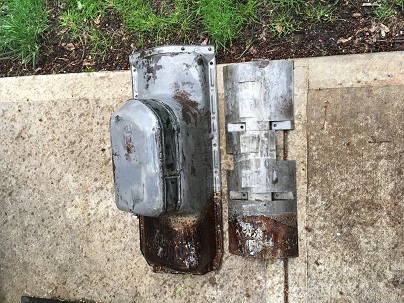

PostPosted: Thu May 03, 2018 6:25 pm
been in a solution of 2 gallons of molasses and approx. 30 gallons of water for four days
I had about 4 inches of the oil pan and windage tray out of the molasses solution,
the transition line is obvious.
I added approximately 10 gallons of water to the existing solution to get the oil pan and windage tray fully submerged.
this is working well,, for a no effort, inexpensive de-rust.

Nice! It's an old farm trick that works well if you are not in a hurry. Works on fenders, rims, bumpers, whatever you can submerge.
