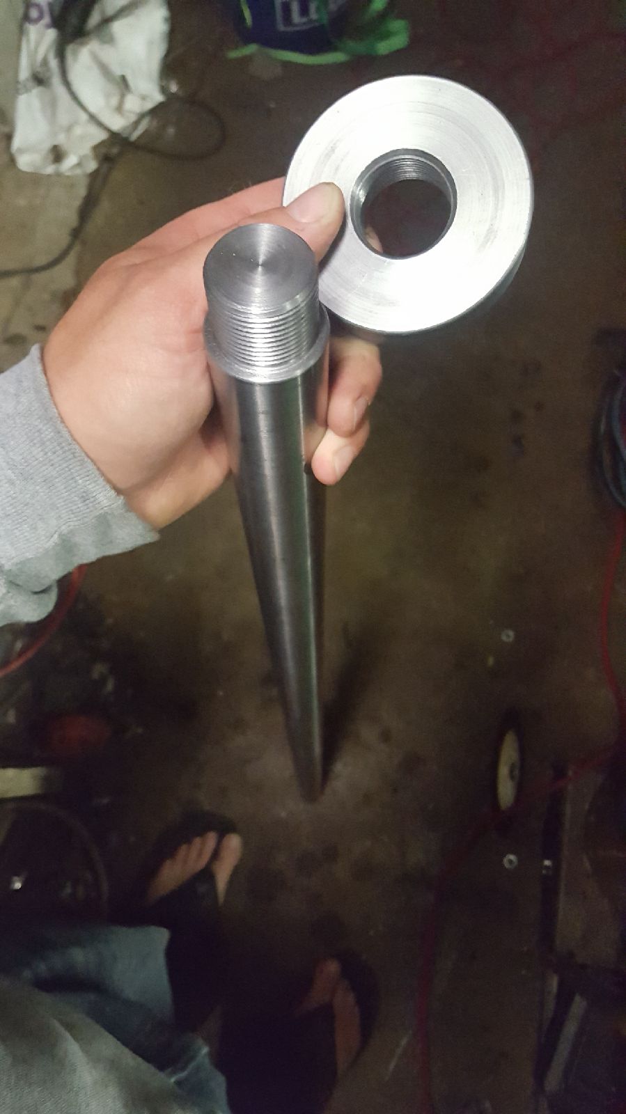

My Lemons partner just bought a cool rod with screw on ends designed to keep your housing ends square. He used to work at a chassis fab shop. First job is to put 9" ends on his Mustang's 8.8. Other projects to follow... :twisted:
