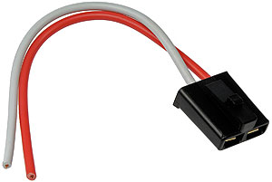

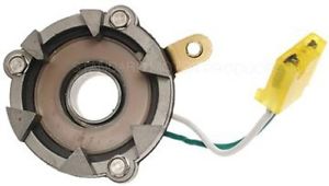

I assume you are using the GM style 4 pin module. You can use two of the Dorman 85841 as it will fit the side with 2 wide terminals perfectly. It will work on the side with the fat and skinny terminal, but it you want something that fits a little better, just get the distributor pickup coil (circa 1976 more or less) and use that. I picked up a Standard LX-309 off ebay for around $5 and just cut the pigtail from that. The Dorman 85841 type connector is widely available just about everywhere. It is the same connector for the (GM) internal regulator alternators.

Hope this helps.
