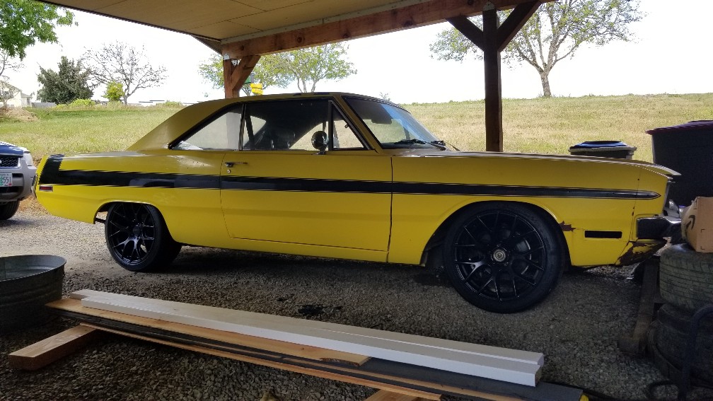

This is pretty close to final ride height. I have Firm Feel 1.12 torsion bars in the front with the top of the fender opening at 24.625". The rear springs are the ones Peter Bergman sells. The wheel opening is 22.25" with an empty tank. I don't have lowering front spring hangers.

I've basically copied Peter's geometry as close as possible since he has put years of testing into his car and it performs well. I think his rear may be .5" lower by using a lowering block. I still need to put the Explorer rear in and the replacement spring perches appear to be a little taller than stock. That would have the same effect and lower the rear a little more. My neighbor kicked the car off his lift so I had to move the project along a little. I was really tempted to modify the 904 transmission crossmember to bolt back in with the new torsion bar crossmember so I could try out all my fancy new suspension parts, but I resisted so I would have to make progress on 6 speed. My next task is fabbing the transmission crossmember and getting a set of 4 speed pedals. I'm having a hard time justifying the cost of used stock pedals that still need to be restored. I'd really like to put in a set of Wilwood hanging or even floor mounted pedals. They would give me the added bonus of adjustable bias without also buying a proportioning valve. I'm considering designing a replacement pedal mounting bracket for Wilwood pedals to give people another bolt in option if a good set of stock pedals aren't available. I'm going to need that clutch pedal soon.
