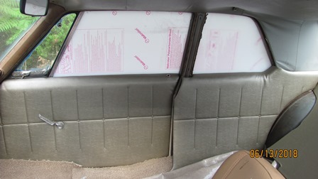

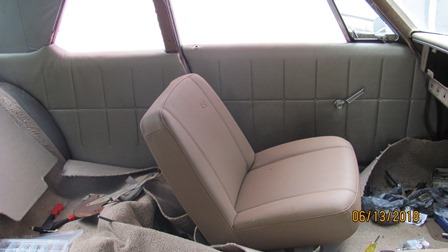

Progress of sorts. Interior instead of engine, but at this point I'll take what I can get.
PostPosted: Wed Jun 13, 2018 5:03 pm
Posts: 399
Location: Pauls Valley, OK
Car Model: 1975 Dodge D100
Really nice! Looks roomy without all the “stuff”.
PostPosted: Wed Jun 13, 2018 6:38 pm
Posts: 1482
Yeah, I haven't really permanently installed the carpet and panels yet, or the seats. Just have to trim the carpet, put the door panel clips in and bolt the steering column in. I am anxious to finish and drive the thing.

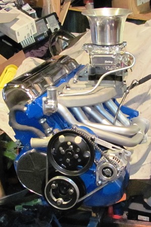

Let's see....3 years,3 ruined heads, 3 different camshafts, probably more.
I am hoping 3rd time is the charm.
Engine is (finally) sealed up and waiting to be dropped in. I may rig up a test stand to break it in first.
This goal has turned out to be almost as elusive as that aluminum head thingie.
PostPosted: Fri Nov 09, 2018 1:55 pm
Posts: 17690
Cool! Dang, screw the test stand. Bolt that sucker in and fire it up!
PostPosted: Fri Nov 09, 2018 2:01 pm
Posts: 399
Nice work! If that engine runs half as good as it looks they’ll never catch you!
:mrgreen:
PostPosted: Fri Nov 09, 2018 5:08 pm
why the additional thermo bypass?
the head heater out to the water pump...
I am thinking you are just delaying warming up the block...
just buzzing coolant around the front of the head...
PostPosted: Fri Nov 09, 2018 6:40 pm
Posts: 1482
It isn't really a bypass hose. It is actually a heater bypass. I have had bad experiences with those rubber hose caps rupturing. The aluminum water pump outlet seemed a little thin to tap for a plug. I figure with this setup, I can easily swap out the water pump without worrying about capping the heater fitting. This is simple and effective, requiring no mods and I don't worry if the thing will burst on me. The hose is a DayCo 87617. It is preformed and looks like it was made for this application.
