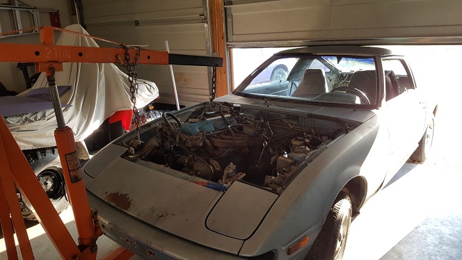

Okay so got a krazy idea as of late.
I am trying to swap in my Slant and A833 into a 79 RX7.
It will fit once I get a rear sump oil pan and pickup.
At least I think it will...lol
Thoughts and or reactions welcome..

Just eyeballing from your pics, it certainly looks like it'll fit. Let us know how it's going, you're not crazy, just a case of slantsickness. BTW, it's pretty much incurable, so don't fight it.

I'd surmise there's a lot of engineering do to with your radiator setup, is there room for a pusher electric fan under that nose? That would help you greatly in room for a radiator. The SL6 is a long motor.
Oh some crafty work but nothing to crazy difficult...

I reckon with a stock 225, A833 4spd and 3.90 gears and at 2300 lbs it should motor.
Warm this engine up and she should teach some 5 litre boys a lesson...lol
