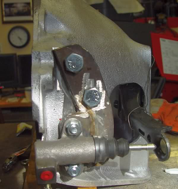

PostPosted: Sat Jul 14, 2018 3:29 pm
Posts: 9375
Turbo Toad on here used this setup. Not sure how well it worked but it moves the slave cylinder back as a puller.
PostPosted: Sat Jul 14, 2018 4:21 pm
Posts: 107
Car Model: 1955 Dodge Truck
That looks promising and less money.
If i have the room could fo this route.
All in the planning stage right now.
The question is can I shorten the long truck type shifter fork to gain clearance?
