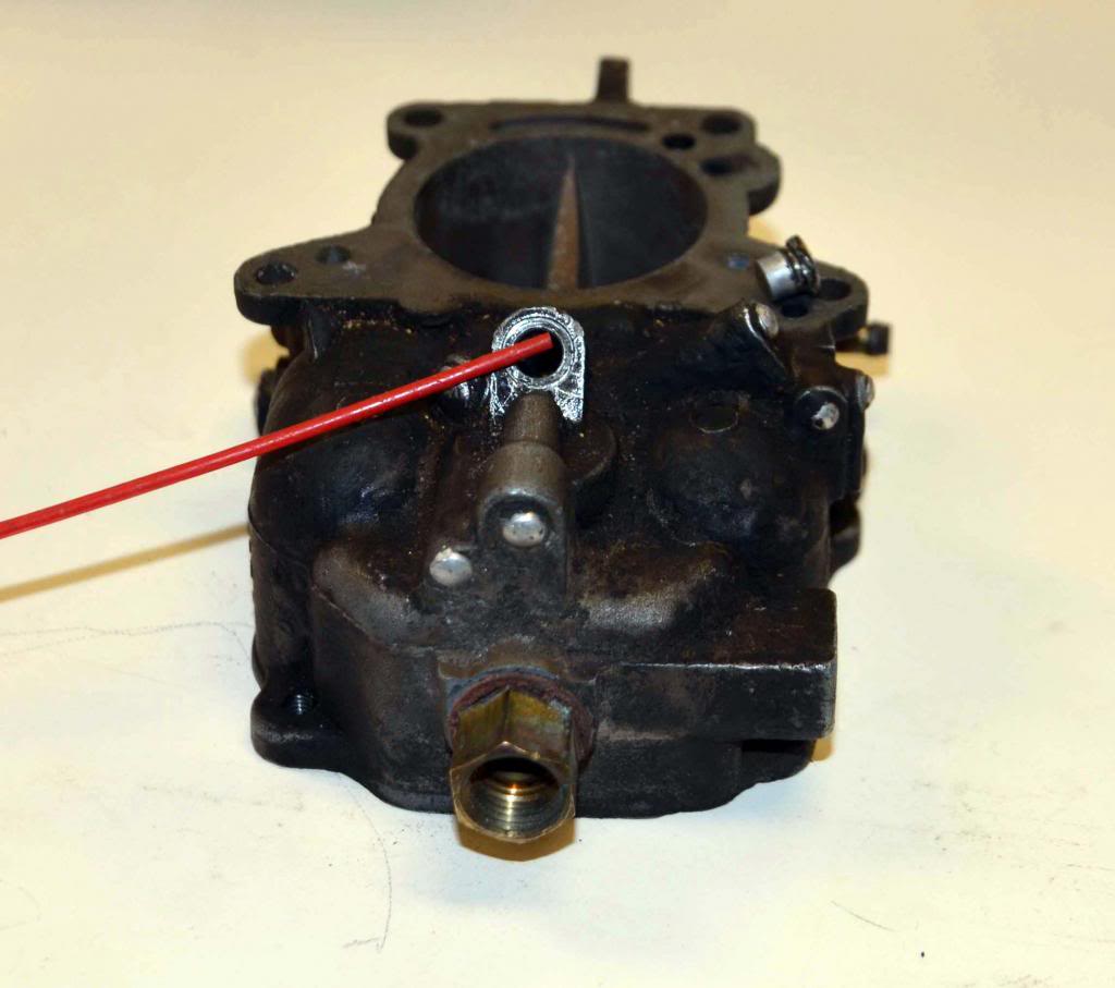

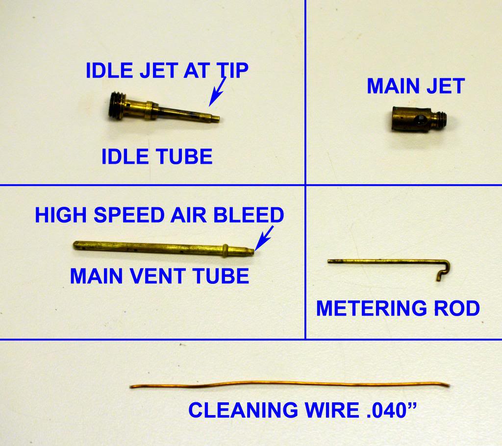

PostPosted: Fri Jul 20, 2018 6:16 am
Posts: 1603
PostPosted: Fri Jul 20, 2018 6:29 am
Posts: 1603
That blue line is top of main vent tube,a little small amount heat, pb blaster,let soak. Flat punch, light taps,should fall out bottom.

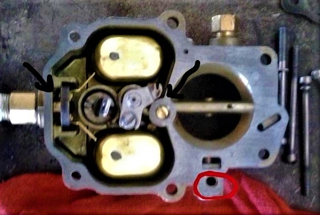

PostPosted: Fri Jul 20, 2018 7:52 am
Posts: 1603
That black line on left points to float pin retainer, make sure its holding the pin down. The main vent tube has 6 emulsion holes,make sure there clean.
