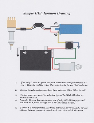

Have a look at this Schematic for a basic idea:

Many people run relays, but I don't, because it is just one more thing to go wrong and I have never had an issue with any of the 5 or 6 vehicles that I have installed them on. Always have had plenty of voltage over at the HEI module so I didn't worry about it. Not saying they should not be installed. Just that the whole HEI set up can be installed very simply. Only 4 wires on the HEI module. And 2 of them go directly to the distributor. Only 2 more connections! They go to the coil! :D :D You got this!

Here is the drawing I use. It is not original with me. Someone made up the nice drawing, I added the notes to help my pea brain remember. Maybe it will help? :D
