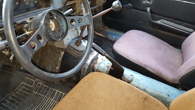

Cut trans tunnel near OEM for the RX7 trans stick.
Installed hurst shifter for the 833 lots of room and no restrictions on movements.
Now it needs to be boxed into the tunnel.
I need to pull the dash and close in the firewall too.

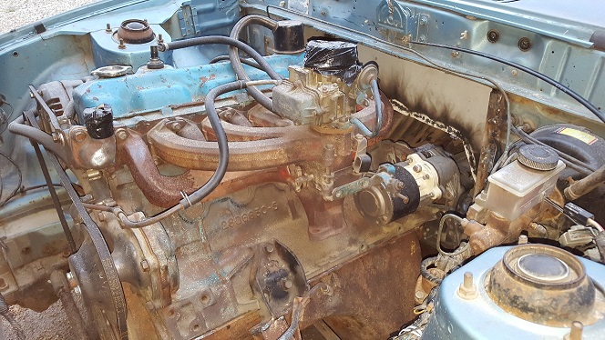

PostPosted: Wed Aug 08, 2018 7:09 pm
Posts: 107
Car Model: 1955 Dodge Truck
sheet metal work is about completed.
Lots more to go, but here are a few pics, of the "Little Bastard"....
