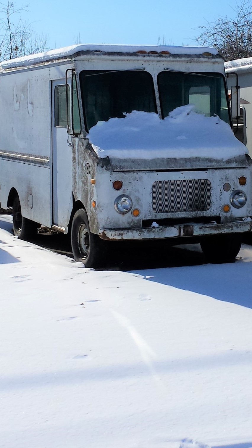

Here are a couple of pics of it.....
File comment: last winter...

Cool. That would sure make an awesome track day vehicle. With plenty of room for napping and spare tires etc.

Hang onto that old carb! Regardless of the drive-ability of the new one, it provides you with a spare that hopefully is the original. In such, it will have the right internals. More often than not, the rebuilt will come with inappropriate jets and so forth.
As long as the core charge isn't stupid high, I wouldn't turn it in, and certainly wouldn't round-file it.
Neat rig! :D
