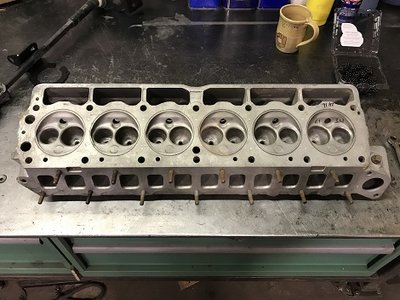

My question is - do any of you have any history or insight on this? Has anyone ever seen one of these scalloped covers in the flesh? I ask because I am in possession of a very early cylinder head with this unique pattern. I'd very much like to use the head on a special project - and am certain I can modify a production cover to work - but if anyone has or knows of a matching cover, I would surely like to see it or know more.

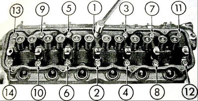

Another early image where the "scalloped" head / valve cover pattern can be seen...

PostPosted: Fri Dec 14, 2018 10:47 am
Posts: 2755
Seen these images many times, but never a picture of the cast iron. There is a family resemblance to the poly style small v8 engines that were around in the late 50's. Do you have a picture of your head to share?

PostPosted: Fri Dec 14, 2018 1:29 pm
"SlantSixDan, SlantSixDan, SlantSixDan."
You know, like when they called up Betelgeuse.
Worth a shot.
As far as I've ever known (or assumed), that scalloped valve cover was always only ever a product of a rendering artist's hand. I've never seen one on any of the first-year Slant-6 engines that have crossed my field of vision over the years, but now you ask I've dug up my '60 factory parts cattledog, and sure enough, there's an up-to/after split on the head and valve cover even in the October '59 edition; see attached. It was a very, very early change, which the footnote makes clear was effective with engine number P22-6-6. That is, engines built on or after 7 June of 1959. With new-model cars being released for sale in September, that's a super-early engine build date. I fear you're in for a long and difficult round of bush-beating to find this obscure part. It will almost certainly be easier and much faster to start with a different cylinder head (the '67-up heads with the revised combustion chamber are preferable anyhow). Unless you're building a points-correct show car or have another reason to require early '60 equipment, in which case...go fish!

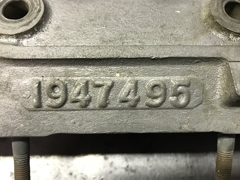

Here you go. It's not cast iron.....

PostPosted: Fri Dec 14, 2018 2:56 pm
Posts: 2755
Fantastic! What a find, good luck with your search.
PostPosted: Fri Dec 14, 2018 3:03 pm
Posts: 1867
Location: Waterloo, Iowa
Car Model: '23 T-bucket
EXCUSE ME? Are you saying that this is an aluminum head?
Roger
PostPosted: Fri Dec 14, 2018 3:18 pm
Posts: 9529
An aluminum head of a design that I did not even know existed! Learn something new each day. What are the marks above each spark plug hole?
PostPosted: Fri Dec 14, 2018 3:25 pm
Joined: Thu Dec 13, 2018 8:59 am
Posts: 19
Car Model: 1960 Plymouth
Roger
I am...
