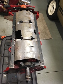

some of the components are:
KB 239 one mm oversized pistons
K1 cast crank rods
King AM rod and main bearings
I-J up and down crank scraper
Mopar Performance windage tray
ARP studs in mains 1 & 4
Milodon BB Chevy tray studs in mains 2 & 3, those tray mount studs are not a low cost item, but they allow for adjustment to get the tray and crank clearance right.
The cylinder head is at a shop owned by one of the engineers that I worked with back in days when we worked for that Chicago base truck manufacturer.
He was an engine air flow specialists then, and he has moved on to that big bore engine manufacturer located just south of Indy. He has a really nice Serdi Valve Seat
Machine, we will see how it all turns out.
