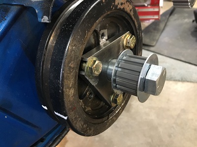

Since I won't spend $200 for a mandrel to drive the oil pump crank gear, I had to make something that will do the job. It didn't appear to be rocket science and with a little thinkin I believe I have the problem solved. (that is of course if it works)
I cut a triangle piece of 3/8" plate and drilled 3 holes for mounting to the crank pulley bolts. Then I drilled a 3/4" hole through the center and this will hold the mandrel centered and the gear back against the mounting plate. I needed some way to get the 3/4" bolt OD to the 1" ID of the gear. I found a sleeve adapter for electric motor shafts that will do the trick. It will slide right over the bolt and be welded to the triangle mounting bracket. It also has a key way already cut into it so I should be able to slide the gear right on to the adapter sleeve and hold it all back in place with the center bolt. Shazam!!! Gear drive mandrel for the cost of the sleeve and a 3/4" bolt. About $15. Add in a couple belt guide spacers and the total is still less than $35. That is more of my price range! Of course if you add in my time it was $399 plus tax!! :D :D

The plate with it's 3 bolts actually will drive the gear through the adapter sleeve with the keyway. Those 3 bolts will be tie wired so they can not come loose and that will hold the mandrel in place even if the center bolt did get loose. The center bolt is only holding the stack of spacers,belt guides and the gear back tight. All driving force comes through the plate. With the 3 bolts being further out from the center of the crank my thinking was that should make it more stable than just the center bolt itself. Probably over thinking again, but we shall see. :D :D

Adapter sleeve for the bolt/mandrel came in and it fits the Peterson Gilmer pulley perfectly. The fit was a snug press on with my bare hands. I cut a chamfer on my triangle drive plate for the adapter sleeve to sit in and test fit everything. Final welding to come while everything is bolted to the engine. I had to trim a little more off of the aluminum plate I made for the oil pump and that allowed the pump to swing in about a 1/2" closer to the crank centerline. By doing that it allowed me to use the gilmer belt that Howard sent me with the pump and keep it as close to the engine as possible. I spoke to Robbie (welder/body guy) and he will stop over shortly and help me cut / modify the rear 2 header tubes to fit the Webers, and make the final weld on my mandrel adapter. I may even get this in for Mason Dixon I !! :D :D

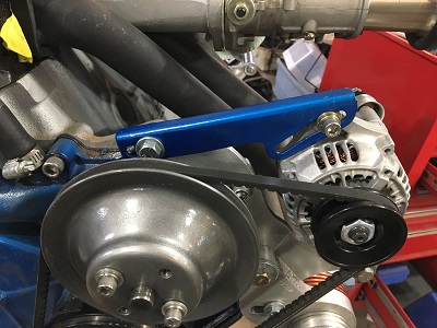

Anyone remember the alternator bracket? That is an unmodified 1980 Airport tug bracket! looks like it was made for it. Now you know why I keep so much stuff!! :D
