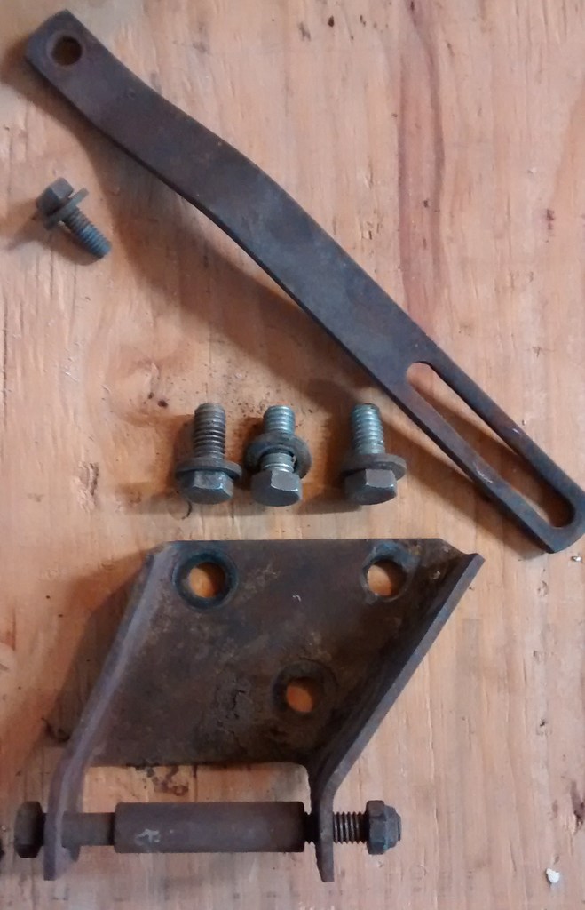

here is an a100 mount. everything should be similar.

Thanks. That is different then the bracket I have.

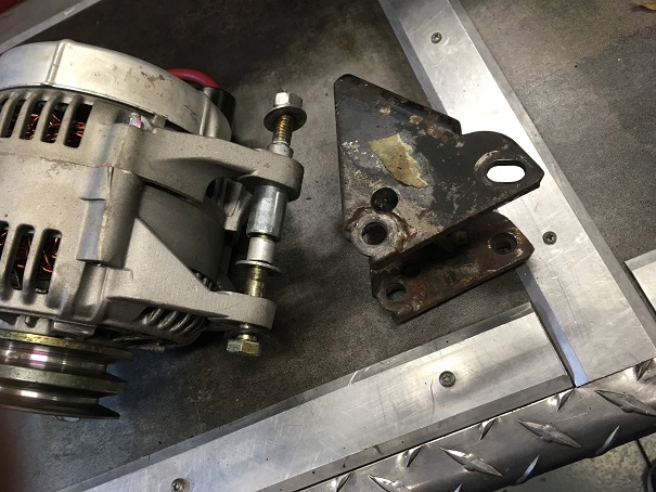

I am sure that I am not the first one to think of this
weld washers on the block side of a power steering bracket,
to close the drop in slots,
get the spacing-pulley alignment right with spacers,,,
presto,,a driver side alternator bracket

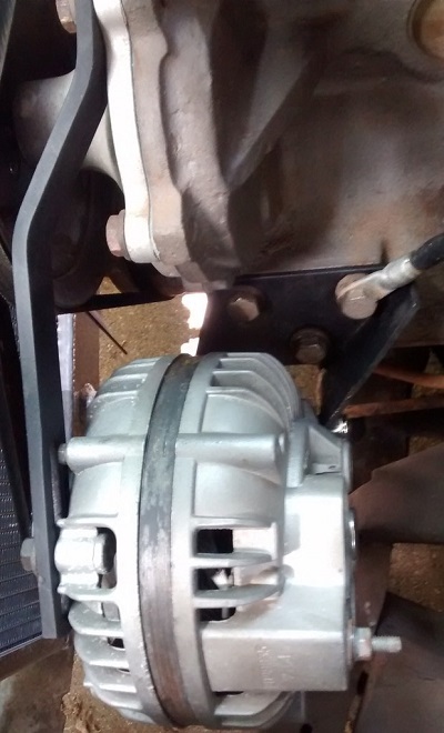

Ok, try this one. This is my old one that I have on the Lancer. I even cleaned up the alternator!

Thanks. That looks like the one I have.

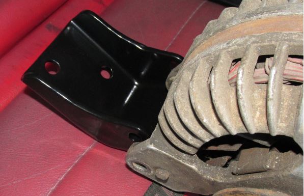

Here is the picture I knew I had!

this is this mount,
mounted on my car. It came off an A-100 Van with a Slant!
Works perfectly with a very short homemade harness.
