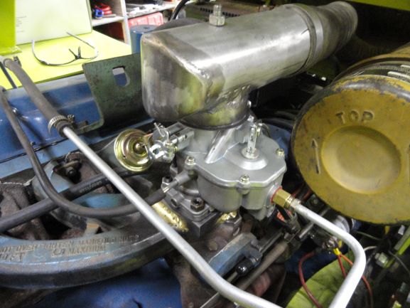

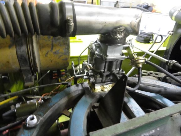

Been reading and researching on here quite a while and cannot find a solution to my problem. Anything I do with this forklift carburetor is frustrating!!! Engine is totally rebuilt and I modified a single barrel intake into a 2 barrel sideways cause I heard they distribute the mixture better and my linkages will work better. I got a cheap Chinese Carter BBD carb off Ebay and It works but not good. The accelerator pump comes on too late and there's no way to adjust it that I see to make it work right. What's the best carb off ebay that works right out of the box? Or should I just go to a fuel injecton setup? I have a machine shop so making anything is not a big deal. It has to idle low so when I shift it in gear it doesn't slam too hard. That's where I need the accelerator pump to come on right away. With the carb I got now the pump doesn't squirt till about 1/3 throttle and by then its already stalling out. I've already broken 2 axles by it slamming into gear cause it idles too high and I don't want there to be a 3rd.

I got another carb for my forklift. This one works better thank goodness. It has quite a few ports on it that I had to plug I think. There is very little stumble after the throttle is opened. The accelerator pump comes on almost right away unlike the other carb. I don't know what all the ports are but I plugged most of them except the one for the pcv valve and the one that goes to the vacuum advance. Hopefully I used the right ports. I'm also running the needles about 1-1/2 turns out and that feels close but not quite sure.
