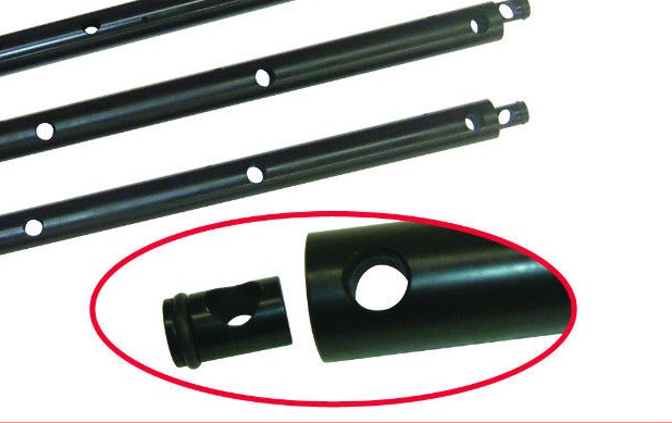

I've looked around this site and haven't seen any reference to anyone using rocker shaft plugs other than the stock press in type (?)
On other Mopar engines, it's common to use O-ringed plugs or NPT threaded plugs for better security and easier cleaning.
Has anyone done this? I'm thinking of driving out my stock plugs and using one or the other of the above type.

Well, the rocker shafts aren't that difficult to clean and the shaft plugs (in my experience) are not really a weak spot on these shafts. Might be overkill on a slant.
PostPosted: Sat Feb 09, 2019 11:31 am
I doubt they will blow out, but then again, oil pressure is oil pressure - whether on a Slant Six or a Hemi. It's good peace of mind to not rely on a press fit. The only difference, of course, is a Slant Six can run without oil for a few months, lol.

I have never seen that failure and have never heard of anyone replacing these plugs. I would say you are more likely to cause damage than prevent a future problem. For reference, I have had rocker shafts on and off Slant engines at least 100 times, probably a few 100, and have put maybe 400k miles on about 10 different Slant engines.
