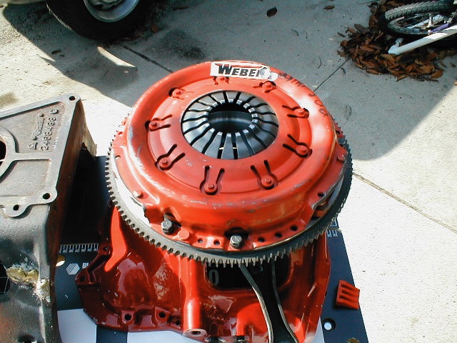

It's really starting to slip now.
I bought the current setup from Steve Magnante back in 2001. It's the parts he used in his Slant Sickness article for Hot Rod Mag.
I think it's an odd bunch of parts.
V8 billet flywheel slightly redrilled for /6
10" 23 spline Clutch
Pressure plate from a Ford something
Time to shop before the racing season

If you have a part# for the Ford Pressure plate that would sure help. McLeod had great stuff, but it is getting harder and harder to put something together that will last in drag race form and not fly apart. That is why I am going 10 1/2" V8 stuff. I am guessing your V-8 flywheel is for a 273 that had the smaller clutch in it like a slant 6? You could ask them about rebuilding yours too.

Like Rick said it looks like your set up was based on the small diameter 273 flywheel that would be necessary to work with the stock slant 6 bellhousing and starter. Somehow they drilled it for a 10" pressure plate from another application that might still be available, there should be someway of determining where it came from by the bolt pattern on the pressure plate. 10" discs are readily available and it you don't want to use the stock lining you could have it relined with Kevlar or metal pucks. At the same time the flywheel register was brought up to V8 size they also fitted later 273s with the same flywheels as 318s and 340s which takes the 10 1/2" clutch you are looking at. You can only use that one with a slant 6 by adapting to a V8 bellhousing and a later flywheel. I suspect you also have the small diameter crank register which would require an expensive custom made flywheel. I found that a beefed up 9 1/4 pressure plate like McLeod used to sell and a Kevlar lined 9 1/4 disc works very well as long as you can keep your foot off the clutch pedal or try to run with the Ebrake on!

That clutch would probably be great but I'm sure that it does not come in the Slant 6 pattern. Call there tech line and ask them how to identify what you have. They may still make it.

I think the one Greg is showing might be the one that fits your flywheel. Although Ford uses a 1"X23 spline input shaft the splines are not cut the same as the Mopar 1"X23 and their disc might not slide onto your input shaft. McLeod used to make 1"X23 spline disc that would slide on either but I am not sure the Centerforce disc would.
