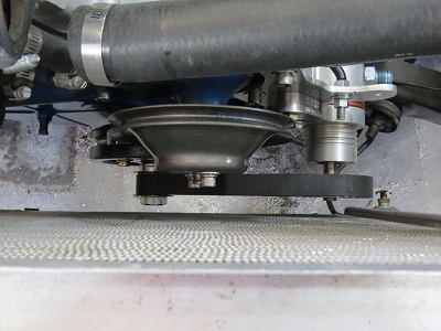

I began the process of the engine & transmission swap this week. If it was only that I would be happy. But I am making a lot of changes and that all takes time. I am usually ready to race by now. I will be pushing it to have this done by Mason Dixon, but I'll try.
I did a test fit of the engine with the new mandrel and oil pump....etc to see if it all fit as I planned. It does and I have just about 3/4" between the radiator and bolt in the end of the crank.
I made a small support strut to stabilize my aluminum adapter. It also allows me to make a small adjustment to get the Gilmer belt running exactly true on the pulley.
File comment: Adapter plate for where the oil pump used to rside

looks great, never fit my lower blower pulley with out moving the rad!! haha. looking at your oil pump block plate, is the hole centered in the block cavity? looks off center, I put mine right on center so flow will separate evenly on raised cast in the cavity. might make no difference once pressure is on it.
PostPosted: Sun Mar 24, 2019 12:00 pm
Posts: 9340
Mine is over the left side main opening. I asked about this a while back and the thought was once it has the cavity filled it should not matter. Soon will tell!

yes once flow starts it should find it`s way!
