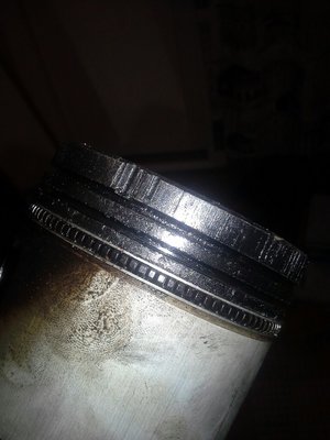

Hi,
My 225 Slant six has several broken piston rings. Cylinders are fine and not even worn that much so I'll hone them and install new piston rings. All the pistons seems to be fine except one, it has slight damage. Do you think that I can still use this piston since the damage is only in the upper part which doesn't need to be sealed by the rings.
I can remove any rough edges with a fine sanding paper plus the piston is softer material than the cylinder so I don't see any problems still using this piston. What do you think?

Look for cracks and make certain that the ring lands are not pinched (rings move freely). You will likely be fine.
There is a slight pinching point which can be seen in the pic but I can carefully work that off. And of cource I'll check the clearances with the new rings. Thank you for your answer!

There are a bunch of 'why's? that go along with this....like why did those marks happen in the first place, and why are rings breaking? I was expecting to see a nicer looking piston...that one looks like it's seen a hard life. Will it run? Of course. But why use it? New ones are $16...unless (from your name) you are not in the USA.
This whole thing wasn't something I expected and/or prepared for, it is already going well over my budget, and no, I'm not from US so there's that.
I know what you mean by the why's. Why there are so many broken rings? Only answer I can think of is that somebody installed them using too much force and didn't use proper tools and technique. Why the piston looks like that? Well in that cylinder the top compression ring was in many pieces and propably one of the pieces got stuck in between the piston and the cylinder temporarily, maybe it eventually got out through the exhaust. The valve and valve seat had pretty bad scoring in them too.

That cylinder has been detonating. IMHO that piston is junk. You can roll the dice and try it, but I wouldn't.

Yea, I agree it's detonation. Back in the olden days, we used to run 440's with the stock cast pistons on crummy unleaded gas...you could never get enough timing in without rattling. When we'd finally take the engine apart all the ring lands would fall on the ground. The rings, too.
Well, the timing was way too advanced when I got the car so you might be right. About the piston...what do you think are the risks of reusing this piston? I mean if I'd carefully remove any rough edges and make sure that the ring groove is ok and the ring has proper clarance in the groove. To my understanding this top part of the piston doesn't really touch the cylinder walls.
Don't get me wrong, I have no intent to argue, I'd just like to hear the reasons why it wouldn't work.

I would really be afraid it's going to continue coming apart.

the ring lands could just about be ready to break apart...…………..

If there is a concern over cracks in the ring lands due to detonation,
Get the piston really clean then inspect the ring lands with dye penetrant.
Either a zyglow type that uses black light or the dye that uses a white powder
as a developer.
I don’t think the crack inspection technique that uses metal shavings and a magnetic
field would work on non ferrous.
An engine machine shop that works aluminum heads would have the ability to inspect the pistons for cracks.
