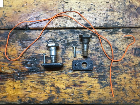

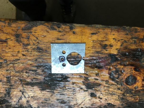

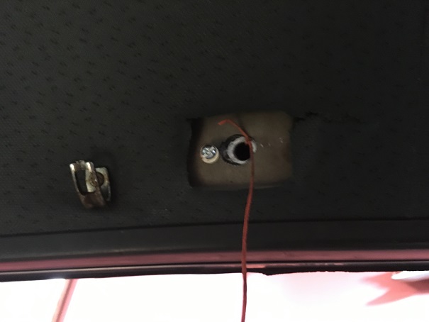

I followed what was done previously but made some improvements in the process. From a gauge that simulated the install hardpoint I was able to develop an EZ process to locate and hold the backstop during installation. The gauge also was used as a template to mark on the car bracket the amount to open up the OE mount hole and to locate the set screw hole. I have posted photos below, but the detail is at the link.

File comment: gauge used for prototyping the process and marking the location to drill the set screw hole in the car bracket

File comment: parts,, the puck is 1/4 inch thick, about .750 wide and 1.5 inches long
File comment: the backing puck with the string attached and the set screw started
