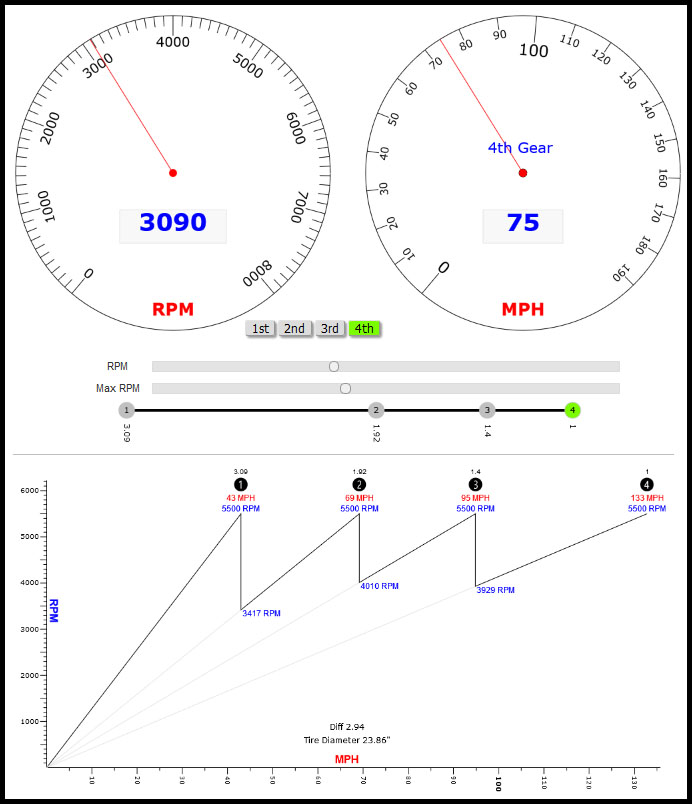

I currently have sbp front disk brakes(KH) and a spb 8.75" 2.94 rearend in the car. I have a set of 3.23's but am willing to buy whatever gear set I need and sell the others to make this work. I would really like to run 16" wheels but the only good selection of tire is for one size, 245/50/16, which I might prefer because I am willing to give up a little handling for a more classic muscle car look. However, I would have to have custom wheels made unless I switch to large bolt pattern, and I'm not opposed to switching but have some questions perhaps for another thread. If I have custom wheels made, then I have a limited selection of 17" wheels should I decide to try them...if I switch to large bolt pattern I have better options...but...back to gear ratios.
After I had the tire diameters, I started playing with the gear ratio calculator. I started with a plot of what is in the car now. The plots will all show the rpm at 75mph, and the mph at 5500 rpm shift for each gear in the trans.
As you can see, driving to California on I-5 and trying to keep up with traffic taxes my poor little half million miler. As measured, my tires are actually a little shorter than theoretical, and I'm actually going 72 mph @ 3100 rpm as verified by my home made GPS speedometer and speed warning signs in the Siskiyou and Shasta mountains.

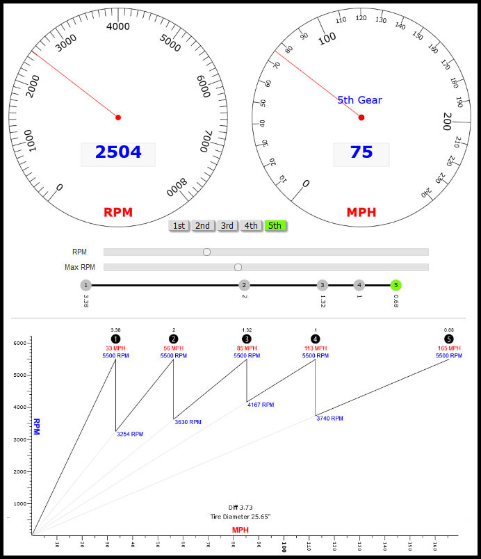

With a 245/50/16 tire and wheel combo, I will need 3.73 gears to turn 2500 rpm at 75 mph as can be seen in this plot.
One thing to notice is the 10 mph change between the first gear shift points. My little engine has never seen the high side of 4600, cam is long out of breath by then...
The final drive ratio of my current setup is 3.09*2.94=9.085, the tremec with 3.73's would be 3.38*3.73=12.61...However, corrected for the change in tire size to compare it to my original setup becomes this...23.86/25.65=.07, 1-.07=.93, 12.61*.93=11.72
That's a significantly lower first gear than I have now, even though the taller tires helped. Hmmm

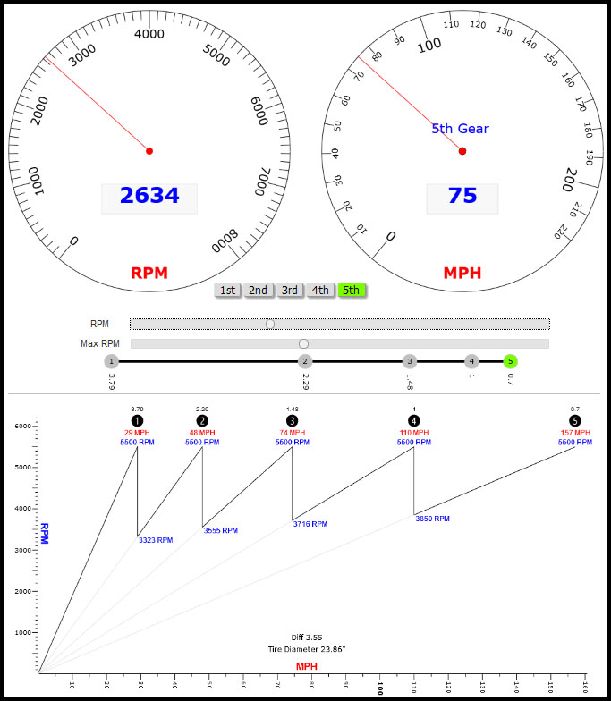

My experience was with a 65 Valiant and a mild 170 (BBD, Comp 252).
I put an A535 (3.79, 2.29, 1.48, 1.00, .7) from a Dakota in it and tried 2.76, 3.23, and 3.55 gears behind it. I had 225/50/15 tires on cop rims on the back.
All the gears were useful with any of the chosen ratios, but the 3.55s were 'track' oriented and the 2.76 were more 'street', just as you might expect. The short tires helped the 2.76s at cruise.
Smaller or worn out engines like/need help getting off the line, so the lower first gears as well as the closer gear spacing commonly found in 5-speeds make for a more enjoyable (and, dare I say, "modern") driving experience.
Oh, and better burnouts :twisted:

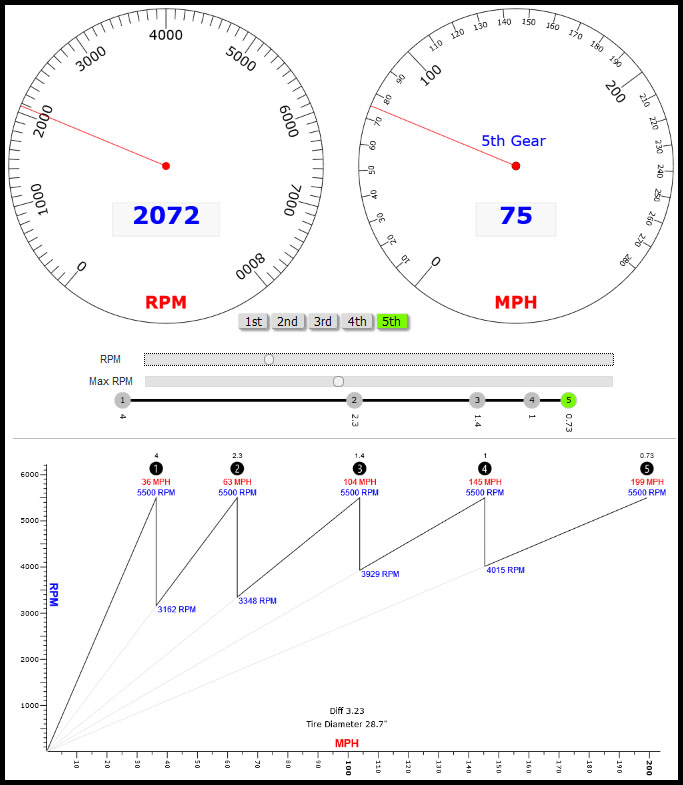

1995 Dakota Magnum 318 (295 lb/ft @3000), NP3500 (4.0, 2.3, 1.4, 1, .73), 3.23, 215/75-15 (27.5 dia).
First gear is very useful even in normal driving, even though it seems too low 'by the numbers'.
Most modern vehicles (with a zillion gears) have very low first gear ratios.
Don't be afraid of it :wink:

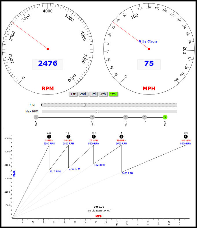

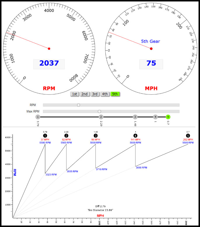

Hi Guys, sorry for the delay in posting, but this week turned crazy. My dad had to go back in the hospital and I have been coordinating with my sisters how best to deal with the situation. I'm going to have to go back to Ca. early next week, and I need to fix our Camry(needs timing chain) so I don't blow another transmission adapter worth of cash on a rental car.... It seems like every time I sit down for a minute, the phone rings with a new demand on my time.
That said, I did do some graphics for the gear sets posted, and have been thinking quite a bit about what I see. Also, I went and tuned on the 60 Vette after installing my wide band O2 sensor. Turned out to be nothing related to gear ratios or cam loping...just way too rich. Idling at 11.5, part throttle at 12-13, down the freeway at 12.5. I changed the jets from 68 to 65(Quick Fuel carb) and the power valve from 6.5 to 5.0, readjusted the idle mixture, and the car came around and ran fantastic. Idles at 13.7-14, part throttle accel 13.5-14, full throttle a bit rich at 12.5, but cruise just right at 14.5-15.5.
Anyhow, I will post the graphics I did for the various gear combinations mentioned, there is definitely food for thought here, but I have no time for my usual dissertations. Just wanted everyone to know I haven't abandoned this thread.

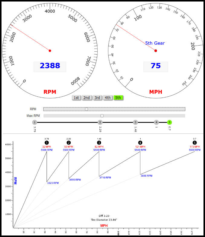

So Sixinthehead posted the various ratios he has used in his truck with a much lower first gear than most cars. I did calculate the tire diameter for his ND3500 graphic, he said his tire size was 27.5 but the math says different. He is more than likely right, since my own tire measurements don't reflect the math, however, for consistency, I am using only calculated diameters based on standard tire sizing. The first three graphics reflect the 225/50/15 tires he said he was running at the time.
Here is his plot while running 2.76 gears...
And here with 3.23 gears...
And here with 3.55's...
And here with 3.23 gears and a NP3500 tranny...

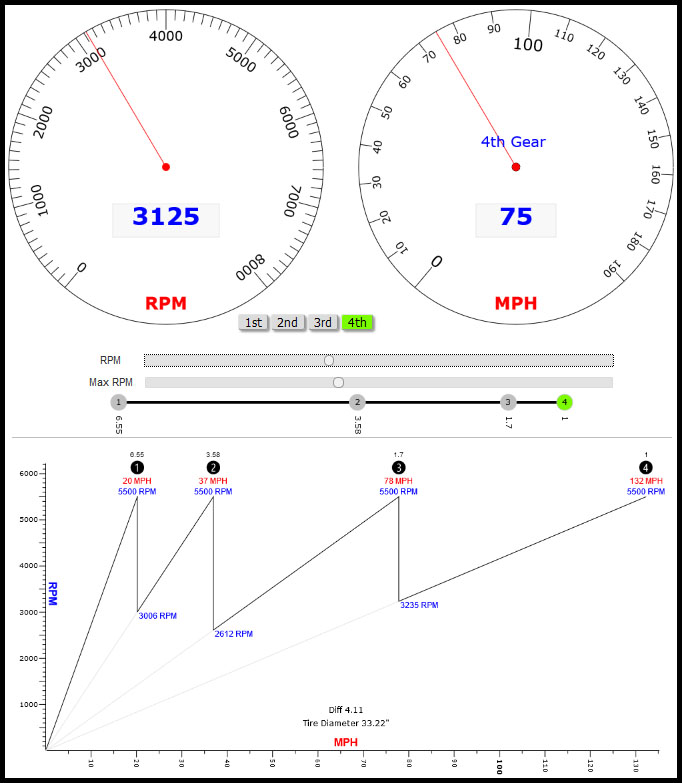

Here is an interesting comparison, my 70 Chev 3/4 ton with the truck 4spd. Meaning unusable for daily driving granny gear in first. I'm stuck driving this every day so I no what low gears are...
And last but not least, Lou's ratios. He didn't give a tire size, but I know from various posts I've read that he runs 225/45/17 at least some of the time, so I used that here. Lou, if you think a different tire size would be a better representation, just let me know and I will change it or add another graphic...
