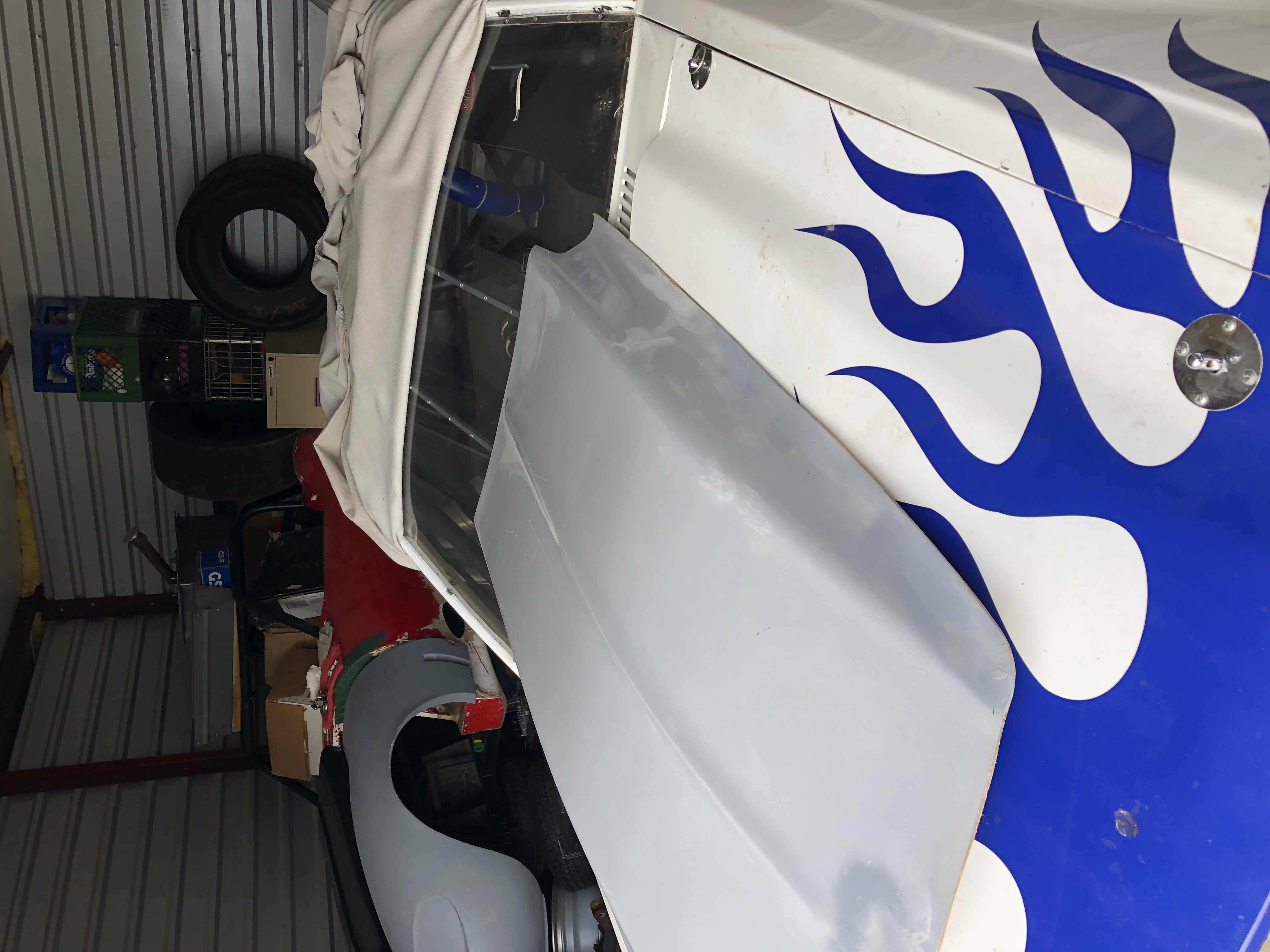

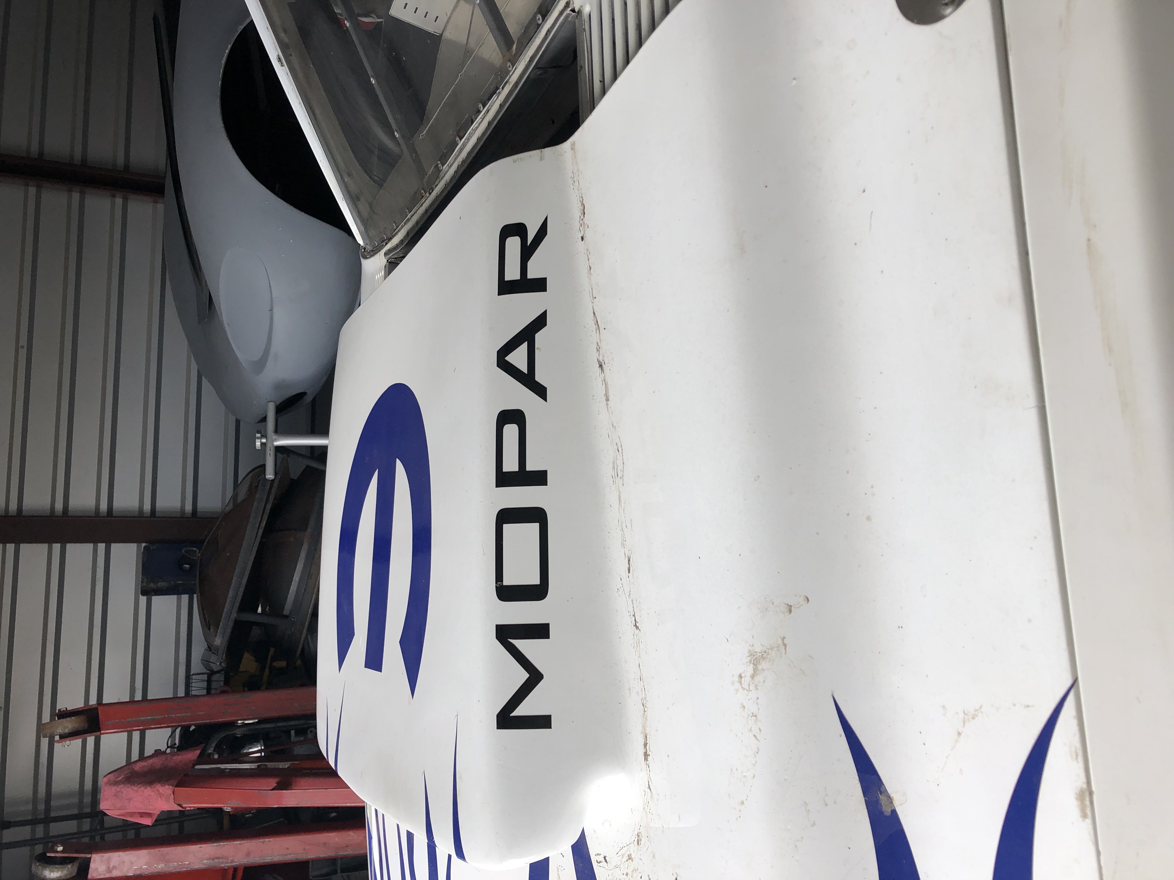

The tape certainly slowed the leak, but there is still a little moisture. At least that tells me I’m on the right track. I’ll pull it again and use loc-tite when I get back from Colorado. The radiator cap would not hold pressure past 7 psi, so I will have to attend to that and re-test as well. I’ll call that progress anyway.
I also got a fiberglass cowl induction hood scoop to replace the one on there now. More progress.

The current scoop is very “Mopar”, but is not sealed at all. It just lets the air blow past. The cowl scoop, along with sealing off the grill area, should help with some aerodynamics as well. Or at least that’s what I tell myself... :D
