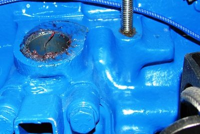

OK, Again, the following are just my observations concerning early and late distributor mounting styles. Part 1 showed both styles on the early, 1973 block. Part 2 covers the later, 1979 style block.
This pic shows how the 79 block is cast.

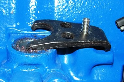

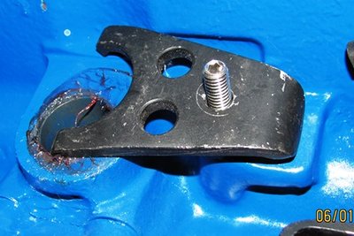

The stud is not standard, but to the right of the stud (to the right in the pic-actually towards front of engine)you will see the ledge that gives the claw leverage.

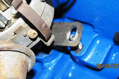

This shot shows that an early style will work on the later blocks because the bolt hole (where the stud is) is in the same place on all the blocks.
So there you have it. The slant six world of distributor mounting, for what it's worth, more or less.
