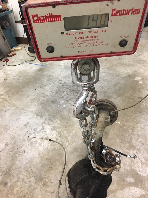

I pulled the 7-1/4 out of the Valiant tonight...after 52 years of service it's headed for the differential rack outside.
Though I'm a fan of the 7-1/4, I'm changing to an 8-3/4 for a few reasons.
I have a big pile of 8-3/4's I need to make use of before I die
I wanted the big bolt pattern
I have a bunch of third members with different gear ratios already
But....the 7-1/4 has some distinct advantages...it weighs less and rolls easier. For the average A body with a Slant Six..it's plenty of rear end.
So, when I get the 8-3/4 all together I'll weigh it for comparison. I'm expecting it to be about 60lbs. heavier. That's serious poundage. Here's the complete 7-1/4 - brakes, drums, parking brake cables, etc.

60 lbs is about right. If there were strong limited slips and gears available for the 7.25, then I would have one in a car.
Likewise. I have been a fan of the 7 1/4, but the parts just aren't available any longer. I had one with 5.13 gears that I am rebuilding with 3.91's. Everything in it is brand new except for the spider gear cross shafts (just not available). Took me about a year to find all the parts and cost somewhere around $400. And I haven't seen the SG clutches for sale in many years. I had one set on hand.

So the later vehicles that used the 7-1/4 don't provide a source of parts? Like, didn't some Dakotas use the 7-1/4? It seems like trucks would have used Sure Grips, etc.
Then, there's the added weight that comes with the bigger tires/wheels you migrate to with the bigger bolt pattern.
The only saving grace is that if you have to add 60lbs. to the car, the rear end is one of the better places to add it....at least it's not over the front axle. But, it is unsprung weight which ain't good....

The dakotas. And f-j-m bodies with sure grip that I have seen were 8.25's..
I think sure grip 7.25's were phased out early 70s or so

Planning to put an 8-3/4" in the Lemons Dart some time this year, but we already have an 8-1/4" (from a Jeep) so it shouldn't be as much of a weight hit. We switched to that from the 7-1/4" partially because it was an easy/cheap way to get better gears. Speaking of which, Greg... got any 3.55 pumpkins you don't need? :D
One supposed benefit to the 8-3/4" in road racing is the lack of C-clips, although I doubt that's a major concern for a street or strip car. Granted, we also haven't broken a C-clip on our 8-1/4" in 5 years (~15 Lemons races).

8.75" is about the same wt as an 8.25". Maybe 10 lbs heavier?
