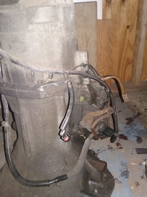

Well, today turned out to be a bust at the junkyard, and it is all my fault. Normally, the easy way to tell if a vehicle has an A500 or an A518 is to look for the "OD" button on the dash. Well, the website for the junkyard said they had a 90 D150 with a 318 and "four speed automatic." When I got there, the dash was completely gone. A904s and A500 are identical from the front to the tailshaft housing, and I am not familiar enough with the A500 to be able to differentiate it from a 904 at a glance. So I spent all day in the junkyard pulling a transmission only to find out that it is a plain old A904, not an A500. I was pretty bummed.

So now I am scouring the internet for clear picutures of the A500 tailshaft housing so I can make sure I get the right one.

I took a pic of one under my work bench. It's an A500 from a 90 dodge Ram Van.
Thanks! Are you SURE that is an A500? It hought the A500s all had a deeper pan? Would you be willing to take pictures of the top, driver's side, and bottom of the tailshaft housing?
Now I am thinking that maybe the transmission I pulled WAS an A500. I though the A500 and A518 overdirve tailshaft housing had the snap ring access plate on the top of the housing and the 904 has it on the driver's side. Am I wrong?

The a500 is the one on the left in the pic. Pan is deeper and the od unit is very large at the front part of the tailshaft. The rear mount has 3 bolts and it is 3.5 in longer.

Also make sure the electrical connector (not the nuetral safty switch) is a 3 prong plug. If it is round with about 8-10 wires, it is an re and will not work. You must get one with a hydraulic (rh) govenor not electroic one (re).

Thanks! I will go back tomorrow and look more closely at the trans I pulled before I tear into the Dakota.

How's this?
