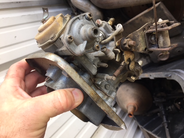

I was at a junkyard today and the guy there said he had parted out a 63 Dart with a Slant Six. He showed me the remains, which included the auto trans ($100) and, oddly, the intake which still had a 1-2 barrel adapter and a Weber carb.
The setup was obviously a 'kit' for the early Slant Six as it is a cast adapter and the linkage adapter is also not 'home fabbed'.
He wants $90 for the adapter and carb. Should I buy it?? I need it like a hole in the head but it might be fun to mess with. Or is it misery to mess with?

Is it a staged 2 barrel or synchronous opening? I think any real gains would come without the adapter and a direct mount to a 2 or 4 barrel manifold.. I ran a holley/weber staged 2V on an adapter on a Ford 250 six and the gain was minimal.

If the carb is in good shape, it's a fair deal. Someone around here is always looking for a good functioning carburetor. Also, if you get the "Jeep" adapter this can go on a Super Six manifold and function well. It's about as flow capable as the Super Six BBD so not a great HP carb.

Thanks guys. I'll probably pass on this as I have too much junk already lol. It is a progressive linkage, FWIW.

That's probably a fair deal for the Weber carb, even if it needs a rebuild. I think those go for ~$300 new. One thing I like about these is that the throttle linkage points the right way for the early-60s stock mechanical throttle rod, so you don't need to convert to a cable throttle. On this one, it looks like someone may have just cut off the U-shaped linkage from their stock single-barrel carb, drilled a hole, and bolted it to one of the holes on the Weber linkage plate (or whatever it's called).
