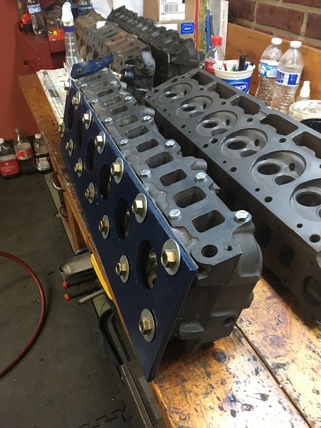

I believe I had mentioned that I had a completely ported slant head that I decided to go back and take another cut inside the intake bowls.
This head had new guides, seats ,,,,and I ended up breaking into the water jacket on one bowl.
I found a machine shop here in Indy that said they could weld it. ( Richards Cylinder Head Repair). I spoke directly with the shop owner, he said he was 99% confident that he could repair it.
They also said they would do a leak test to verify the repair.
The price of the weld repair was reasonable enough, $125.00

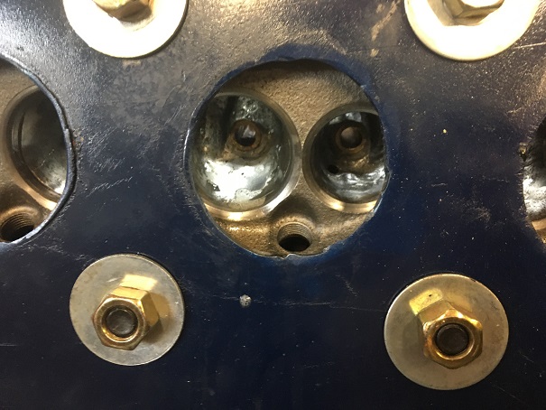

After the repair, I put the head on my leak test apparatus, at 10 psi in the water jacket there was one pin point at the weld repair where, when I sprayed soapy water bubbles would slowly form. You could stand there and watch the bubble slowly fill. Repeated the leak test a couple of times and convinced myself the leak was really tinny, but it was there.
I considered having the head welded again, but I did not want to send it back through the heat process so I looked into impregnation.
Found a shop in Fort Wayne IN that would do one off jobs. (Industrial Anodizing) It ended up being pricy, $300.00 however since this was a finished head and the leak appeared to be the size that impreg would resolve, it was done.
Got the head back and ran it across my leak test process, at 20 PSI in the water jacket, with soapy water sprayed into the port where the weld / leak was, the soapy water lays flat, no movement - no bubbles. I tested it a couple of times. The leak is repaired.
