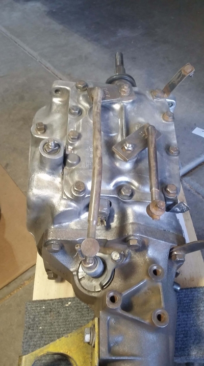

I am building a rat rod. The motor is out of a 73-74 Dart, but the transmission is out of a 1980 Dodge Van. I am not picky, I just need parts that fit and preferably with what I have. Here is a photo of the transmission and linkages I do have.

Oh. A manual trans...
Ebay....probably the best place for a good used shifter and shift arm. Yes, you could make the arm but that's a lot of work for something you can find cheap, used.

Reverse Shift Tab is the same for all platforms, the shift linkage rod is platform specific...since you pulled from a van, you will need the van reverse shift rod, and the van attaching plate and a universal hurst shifter, then shift stick to make it work...
If you don't have to worry about a cross member being in the way, you can install the shifter and the tabs and make your own rods to fit from a kit or fabricate them (they are hardened, FYI)...
