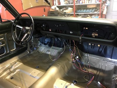

The dash is installed, some of the new under dash wiring is ran, but not all hooked up, the cabin wiring is about done.
The next items are: the under hood wiring, that includes a centralized relay box and to get the valve spring pressure right I need to have the spring seats trimmed, so its
one more visit to the machine shop. Then I can finish assembling the engine and get WV over for an engine install party.

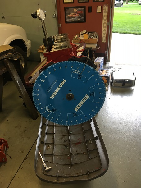

Degreed the cam today. The ICL is set on 100
I don't do this often enough to remember all the ins and outs,,
I called Charlie S and he had me straightened out in a matter of minutes,
but then we had to talk on the phone for another half an hour,
but that's what having this hobby is all about,, its the folks you meet along the way :D

Wow, I like that big degree wheel. I think I need to replace the smaller one I have been using with one of those. Looks much easier to mount and read.
PostPosted: Mon Jun 24, 2019 1:25 pm
Posts: 3864
big degree wheel
I also have an eleven inch Summit degree wheel, that I put away somewhere in the garage.
Looked for it several times and was not able to find it. Knowing that all I had to do to find
the lost degree wheel was to buy another, and since I already had one, why buy another one identical
to first one. So I bought this 18 inch Moroso wheel. And I do like it, the way the wheel in marked it is very
easy to time the cam using the ICL method, and you can still get the individual cam event timing.
And of course, because I bought a second the degree wheel, I found the first one,
so I have two.

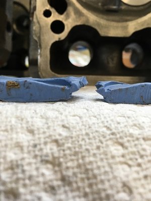

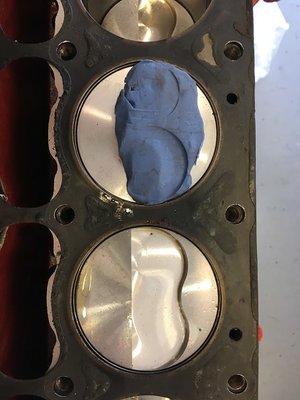

with the cam installed I set the cylinder head on the block, with a used head gasket and checked piston to valve
clearance.
on the intake side the gap gets down to .100 right in the OD of the valve relief.
I believe that is a workable gap. Although that is intake valve shrouding.
So I plan to get in there and buff the valve relief open just a bit.
due to cam timing, plenty of room on the exhaust side.
Used the stock pushrods for this trial. There is a cleanup cut on the block and nothing cut on the head, but the
reground cam has a reduced base circle, I had to crank the adjusters completely in to get the valve lash. A project
for this week is getting a adjustable pushrod made and get pushrods on order.
File comment: clearance
File comment: pistons with clay

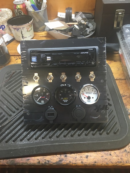

working the wiring, hooked in a battery and ran power to the circuits.
so far so good.
finished the new lower dash gauge mount panel today.
I will build the harness to run power to it over the next few days.
The lower dash panel is an aluminum plate that I had water jet cut to fit the
gauges and radio. The plate cover is plastic laminate that matches the
upper dash.
