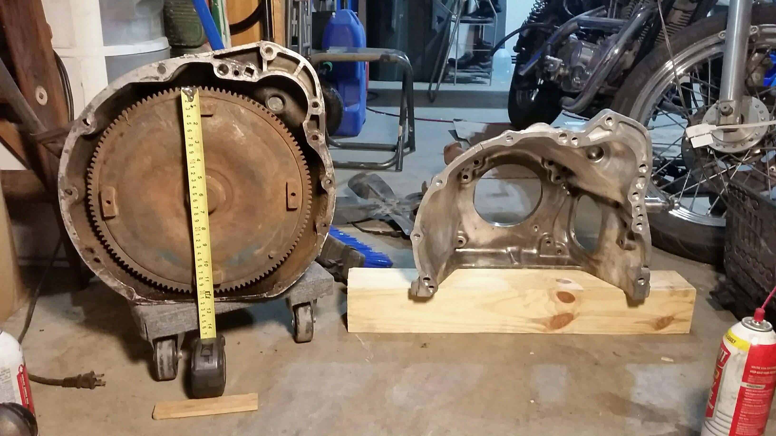

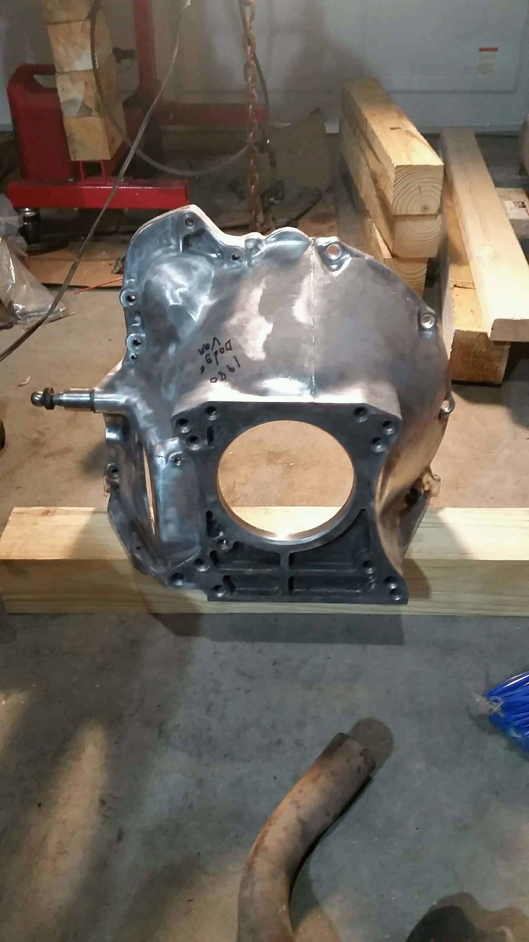

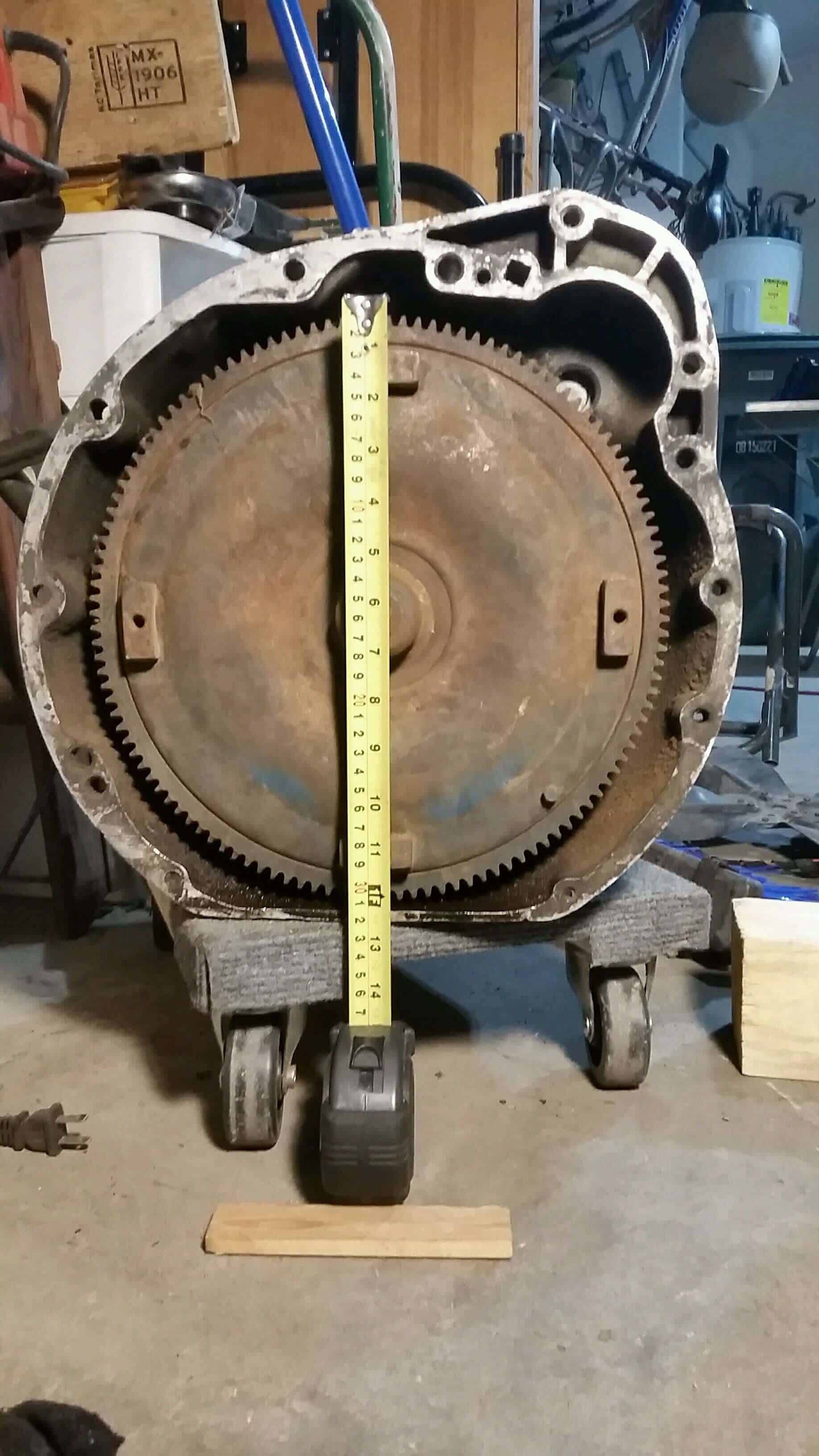

I have some photos here. After counting the teeth on the...ring gear?...on the auto torque converter I have confirmed it does indeed have 122 teeth.
1. DusterIdiot: Measurement side to side was about 14 1/2". The measurement across the ring gear was about 12 1/2".
2. 99% sure I have a slant 6 bell housing based on comparison to my auto trans.
3. I am 100% going to check out the Casa Grand yard. I had not seen any on the regular sites, but I will start calling around.

PostPosted: Tue Dec 17, 2019 3:07 pm
Posts: 3864
yes you do.
