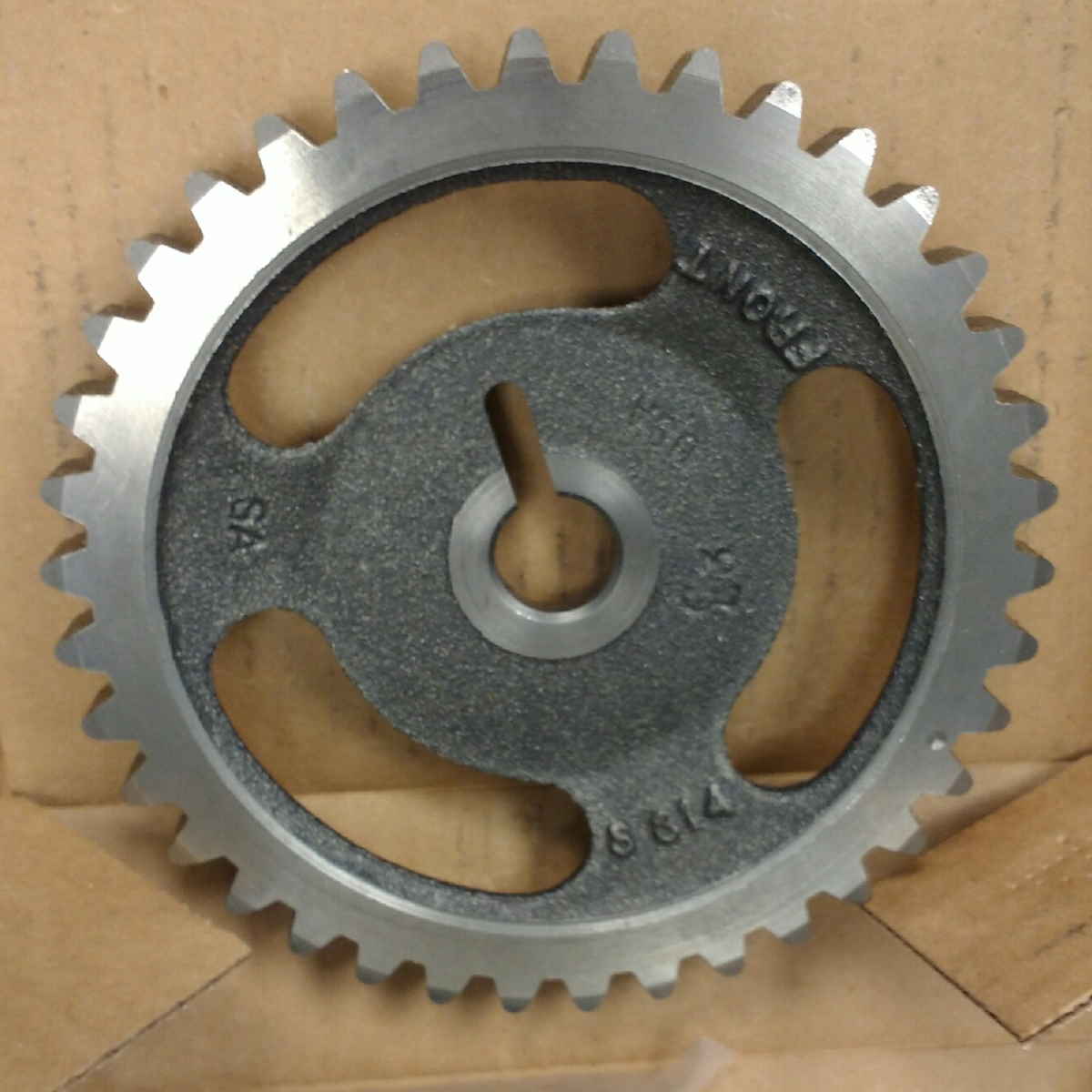

Since this isn't going to be a particularly high winding engine, I thought I'd try the Cloyes timing chain. The picture on RockAuto looked like one of the good timing gears - drilled holes for both the cam dowel and the spokes. Unfortunately, it's the three thin spoke design. This is going back today.
Matt Cramer
PostPosted: Mon Mar 09, 2020 11:06 am
I don't get it...what is wrong with it?
PostPosted: Mon Mar 09, 2020 11:23 am
Posts: 483
Location: Lawrenceville, GA
Car Model: 1966 Dodge Dart
It works but isn't as robust as other designs. That style sprocket is known for having the thin part of the spokes crack at high RPM, and it's harder to get the cam degreed in.
Matt Cramer
