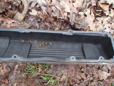

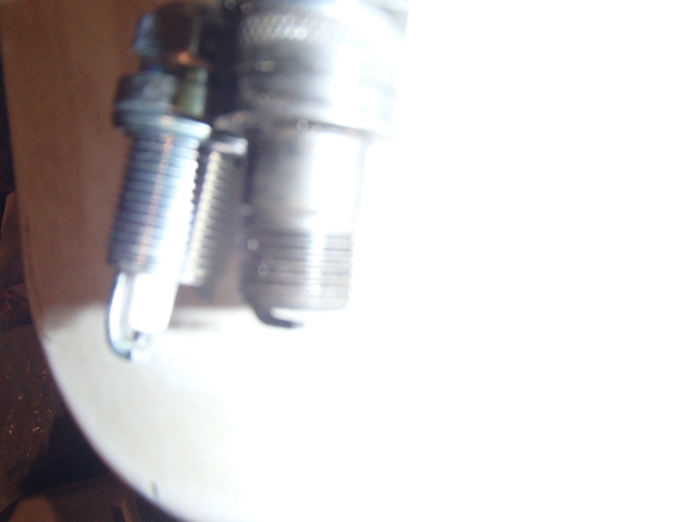

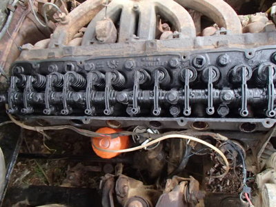

The new NGK ZFR5N is a 1/4 inch longer than the AC and Champion plug that came in this '61 Dodge. Is that going to be an issue??? Took the VC off expecting to find a sludged up engine. Last registered in 12/81 with 57443 miles. Odometer shows 578?? miles. This car has more caked on mud than any car I've owned. I'm thinking this car maybe an original mile car.

In a stock or 9:1 225, no problem, you have about 1/2" to 3/4" reach before the electrode strap contacts the piston face at TDC in the drool tube head...( In the peanut plug head
you can't run a late corvette plugs as the reach and threads are too long and will contact the piston at TDC in a stock 225), FYI.
Yup. That's what makes them work better. As DI explains, there's plenty of room. Don't forget that on a '60-'62 head, you don't remove the metal ring washers from the spark plugs, you leave them on. On '63-'74 heads the ring washers get removed.
