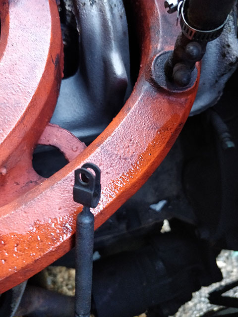

I finally got my super six intake bolted up to the slant in my W150. Problem is the end bit on the throttle cable is not designed for the ball style connector on the weber. Is there an alternate throttle cable I can use or a bit to adapt from its style to ball style?
Pic for clarity:

Take a look at the Lokar S-1034 adapter. Might just be the ticket.
