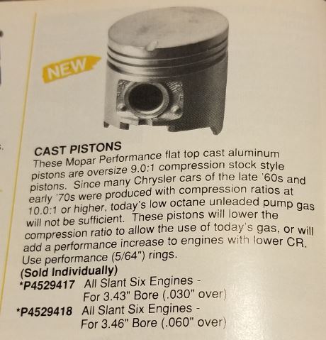

I found this in the Mopar Performance 91 Catalog.

Huh reading that description, it makes it sound like the factory was putting out 10:1 slants back in the day? That would be a new one on me.
Especially when I hear so many stories about the advertised ratio of 8.4 but were really in the 7s, with a huge deck cut, just to get UP TO the advertised ratio? Weird.

Nope, no factory 10:1 Slants, and I can tell you those pistons will not give you 9:1 without 0.090" milled off the deck. Just sloppy/optimistic marketing. They are good pistons, but not worth hunting for. Just get a new set of Silvolites or another good brand and call it good. I have plenty of pistons for the motors I have in hand, but thanks for the offer.

so then I wonder how they came up with "9:1" as their claimed CR?
They employed a simple yet powerful and versatile technique known as lying. It's not the only time, either; many of the parts in the MP cattledog were falsely described.
